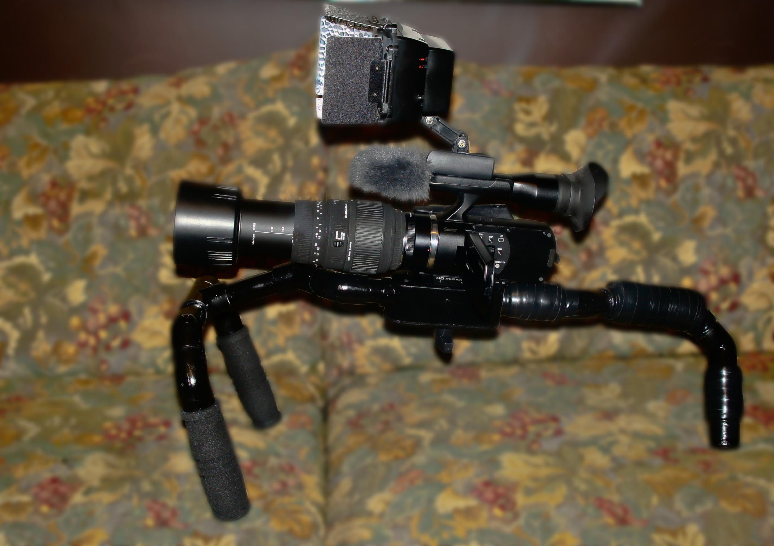

I've been wanting to experiment with some of my longer still lenses hand held on the VG-10, so I started looking at shoulder braces. I didn't care much for the pricing, so I built my own.
I've only played around with it for a day, but I think it has promise. the part I like the best is the cost; $22.00.
I may make another, and incorporate some other ideas

Very nice. It really is needed because once you beyond the 1855 the lens weighs so much more than the camera. And, the two handles provide lateral stability which is really needed.
Can I use your pix in my book?

it does seem to work well. I've just finished shooting a little video indoors with it , using my $3.99 zoom pull, and together they work quite well.
You most certainy can use the photo, by the way

thanks! I'm actually quite pleased with the way it performs with long lenses. Seems to make a good deal of difference to my untrained eye.
Nothing special about the construction; 3/4 in. thick wall PVC pipe, a PVC electrical box and a half dozen elbows. I have enough bits and pieces remaining to built another that will position the EVF at just the right spot for my eye. I'm also going to add a quick release sling from the T in front to the bottom of the "over shoulder" hook for a bit of security. It'll actually hang from your shoulder without havig to hang on with both hands, so a sling will make it a bit more convenient to carry when im not actively shooting
