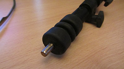

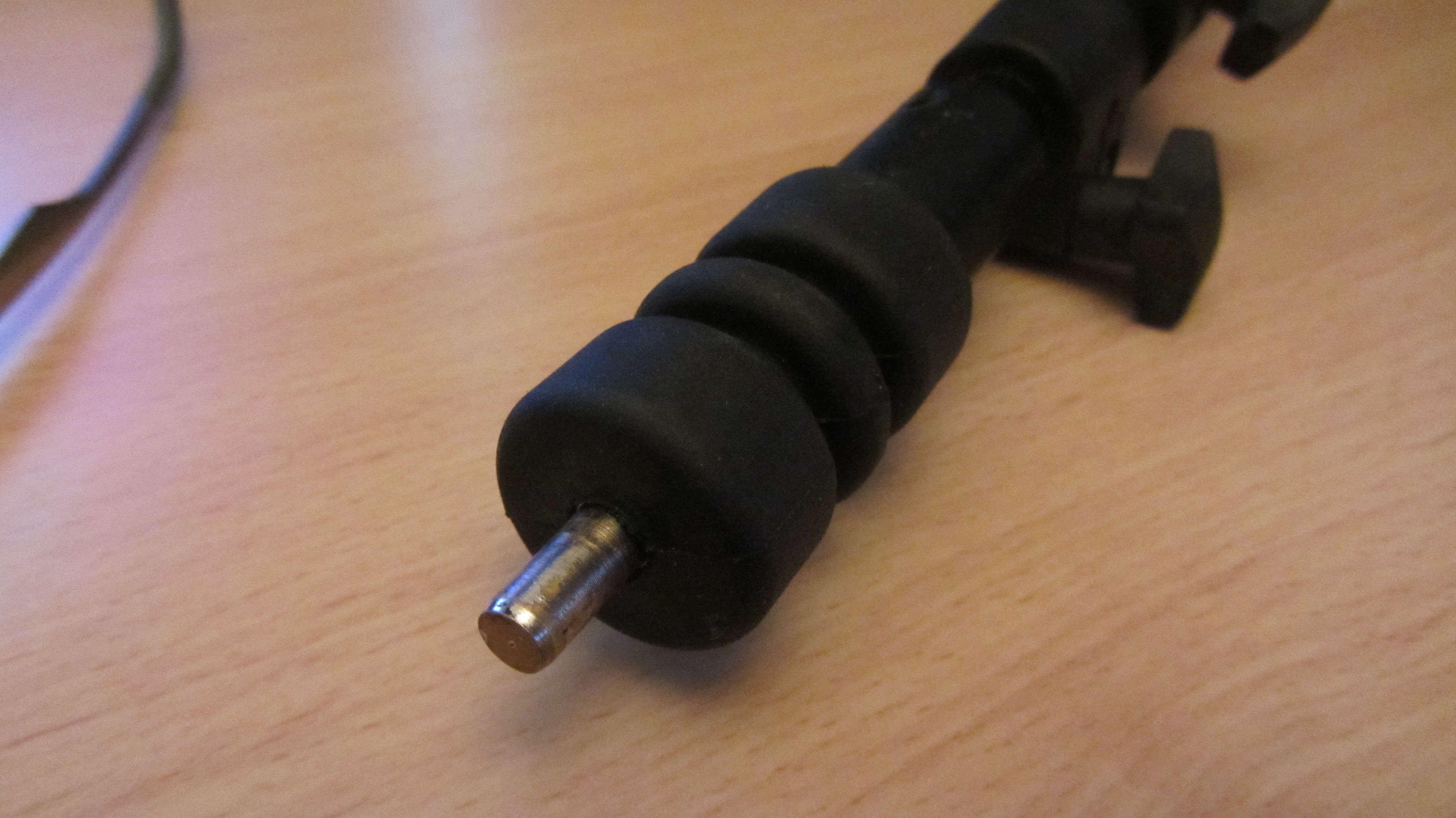

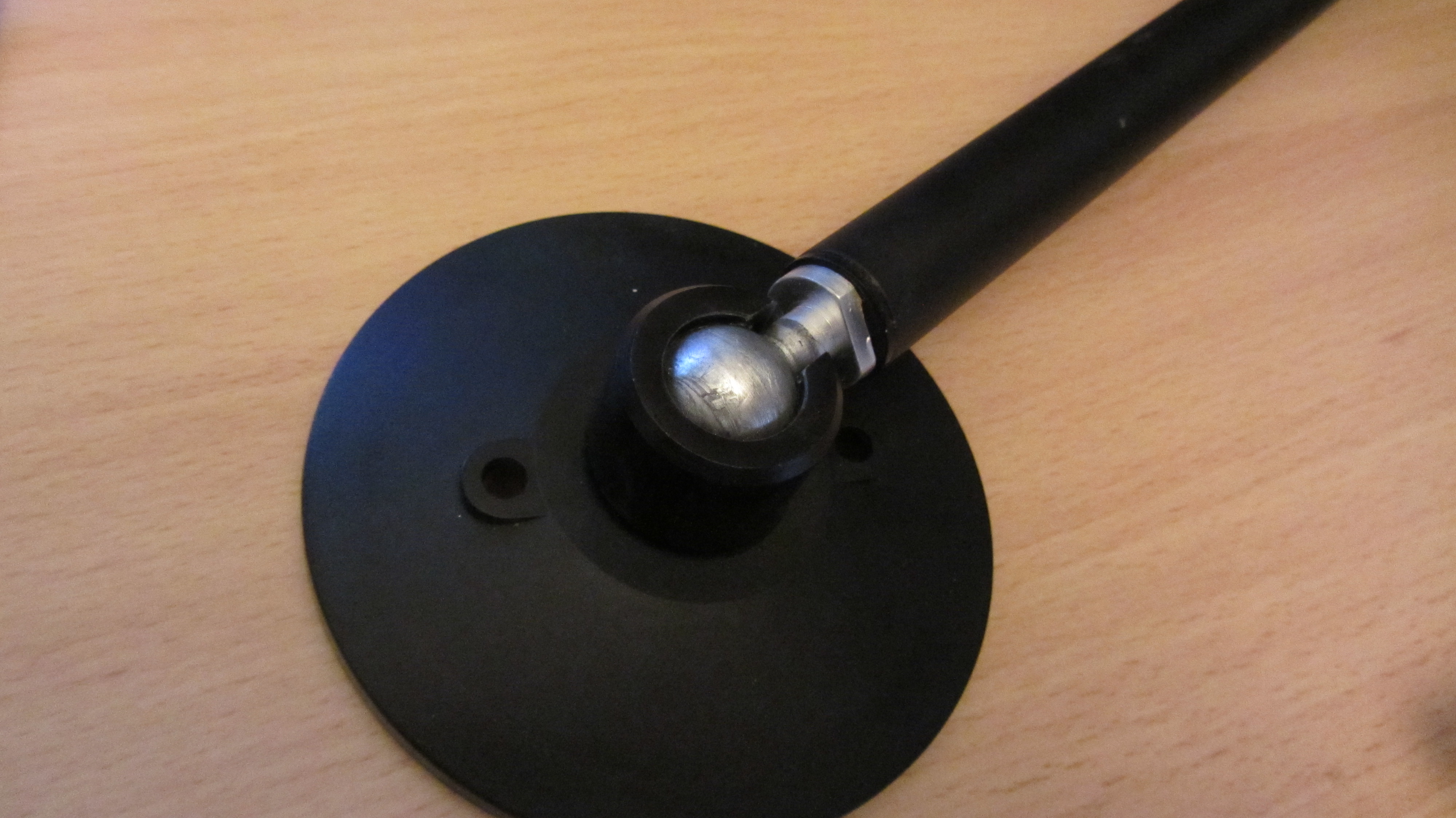

This is the one I have Noa - there are a few versions around - this is a fairly cheap one :)
DSLR Rig Support Rod|Shoulder Mount|Waist Belt
The bit that goes into the belt is on a plate with a ball and socket so you can pan relatively smoothly without moving your body and the end that slots into to rod adapter is flexible to allow for small tilts
I bought it mainly to help my back as I used to get back ache late in the wedding day with my EA50 but I found the rod was a little too long - Chris Harding posted a way of cutting it down a little but I never got time to look at it.
Now you have brought it back to my attention I dig it out for these 2 pictures and will have a play around with it - I won't get rid if it as it did help with my back but now I'm using the A7s it's not too much of a problem unless I use one of my heavy lenses.
The good thing about it is that the rod adapter is not fastened but simply slotted on so you can instantly remove it for really low or high shots.
Both sections are sprung but the damping is not particularly smooth - I guess because it's a cheap one.
waist belt with spring loaded support options-img_5712.jpg   waist belt with spring loaded support options-img_5713.jpg
