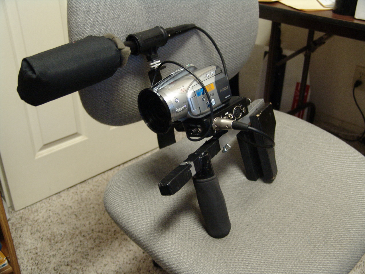

I want to use the hv20 for weddings and don't want to use a tripod all the time. Actually I want to make a homemade schoulder mount that I can connect to a tripod. So when I want to use the hv20 on shoulder I disconnect the hv20 with shoulder mount from the tripod :)
Of course there are some cases that I want to use the viewfinder. Maybe it’s possible to construct a homemade shoulder mount which is also useful in combination with the viewfinder.
Can you post some pics of your self built shoulder mount? I'm very curious how the canon hv20, or another small/light camera, will perform on schoulder.

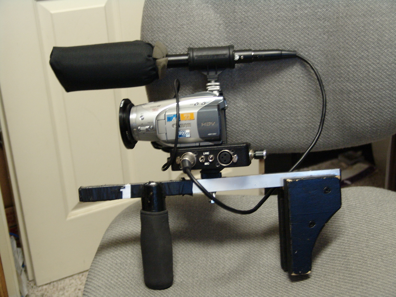

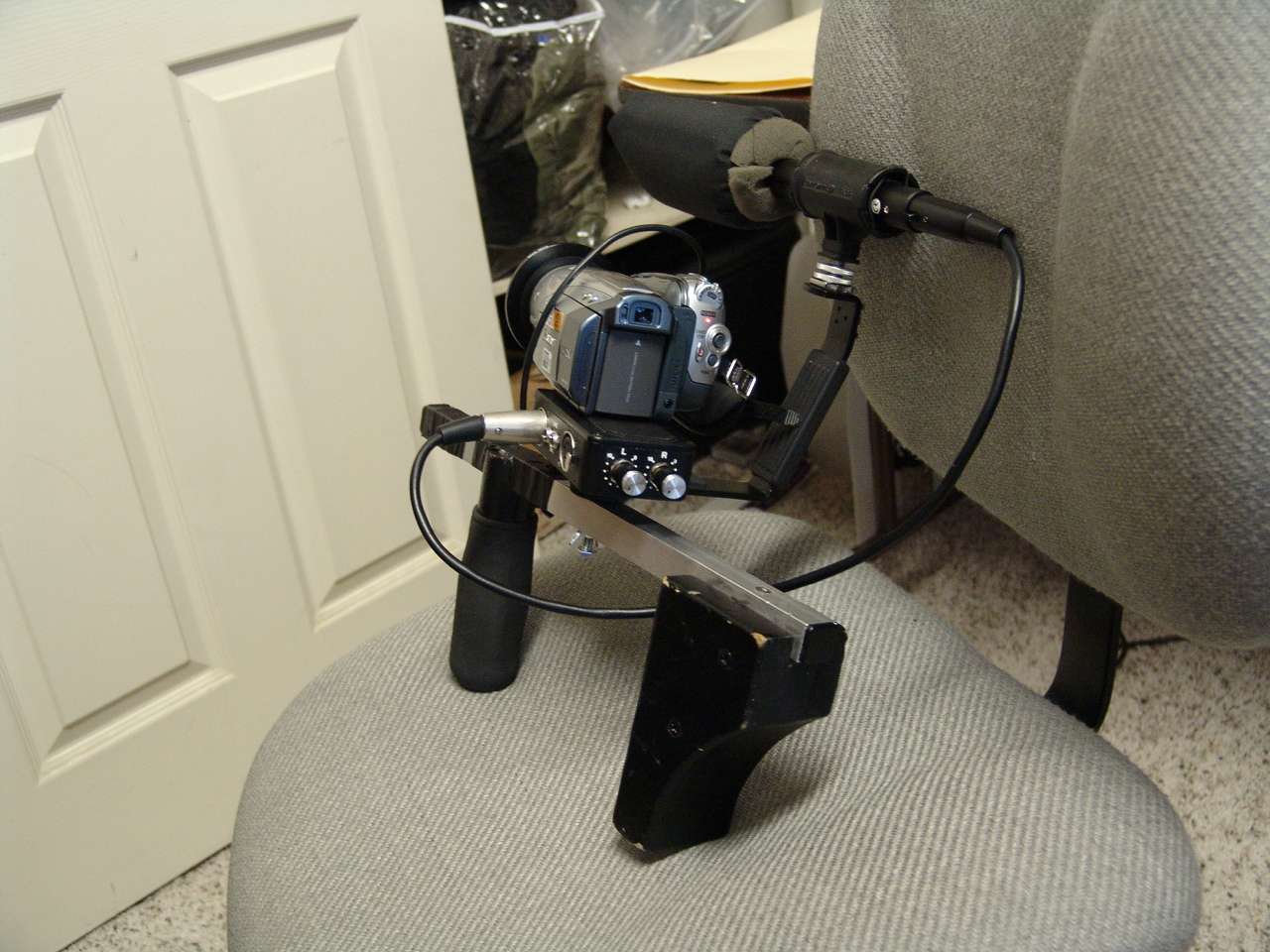

Daniel:
This is very simple, but works well for me with my FX1, VX2000, and now it looks like it fits with this. Haven't really used it this way, but it feels pretty light this way, and I can actually look throught the viewfinder.
Canon HV20 shoulder support-dsc06569.jpg   Canon HV20 shoulder support-dsc06570.jpg

Hey Chris, that's pretty cool. I just did the a similar thing to my spiderbrace. It really keeps it from twisting left and right.
