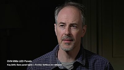

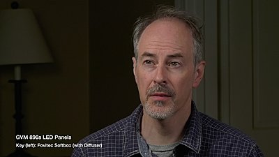

With softboxes you can lower your key to illuminate the eyes without blinding the subject. There is no denying the benefits of soft boxes its just a matter if you can or want to spend the money and time to add them to your kit.
Last year filmed a video testing out led panels with and without light modifiers, never had a chance to fully produce and post it online but here are couple of stills that show the difference in light quality. The same light and camera white balance were used. This particular softbox warms the light.
Please Critique My Work!-no_softbox.jpg   Please Critique My Work!-softbox.jpg

It's not just about eye shadows but overall softness..the shadows everywhere on the face will be softer and overall the light will "wrap" around the face more with a softer source.
On one man band shoots where your time is limited the built-in diffusion panels on many LEDs or the inexpensive softboxes you can buy, the point being something you can set up quickly, may have to suffice. I have the D-fuse which are maybe 24" squares for my Dracast 1x1s, they look quite nice, to me. Closer you can get the light, the better, to the point of talent discomfort or undesirable hotspots from light being too close.
But if you have more time and are willing to invest, what many folks are doing now (at least on the shoots I'm on locally) is putting their LEDs through a 4x4' diffusion. They make collapsible frames for these can different ways to mount them on regular light stands or C-stands.
Depending on how powerful the LEDs are you may need to gang two or more lights together for the required exposure but the 4x4 gives you a super soft light in a typical position for one interview subject. If you angle it more to the side you can keep the softness/wrap but get a more dynamic look (no so flat lighting across the face).
Some DPs when using a large source like that don't even bother with a fill light/source, just let the key and the edge light plus whatever's bouncing around the room fill in. That'll be shoot specific depending on desired mood, etc. Some clients want a high key look.
And like they said placing the talent as far from the background as you can while still getting the shot size/focal length you want helps with everything.

I wasn't thrilled with the D-Fuse. They are light, compact and very portable. On the down side they're shallow not providing a lot of diffusion and were too big for my panels (not their fault) as a result I couldn't control the angle. They're expensive with the crates but without them the spill is unacceptable. I preferred the Fovitec great diffusion and amplified the light but it didn't have crates.
Like you said the placement is also important. Ideally 2-3ft range. Not only do hard lights without diffusion produce unflattering light they make the subject uncomfortable. Large part of a successful interview is a relaxed subject.

I think the D-fuse are okay for ease of use, and the softness is quite a bit better than the raw panel. My Dracasts allow the yoke to be adjusted such that you can change the angle...you just have to mount the yoke on your stand 90 degrees compared to where you're used to (yoke has both a vertical AND horizontal mounting hole). Goofy, but works.
I don't know that I'd get 2-3 feet away, that's pretty close...you don't want to crowd the subject. Typically I see others (and follow myself) at least about 6 feet away. Sort of leave a "sacred space" around the subject.
NOW, in some more elaborate interview setups, for instance two or more cams where you see both interviewer and subject, yes, I have seen Divas or LEDs armed out more overhead and much closer but for single cam like the example here I'd back that light off. I mean if it doesn't have the output to be that far away with diffusion you do what you have to but I'd probably start at 6ish feet.
