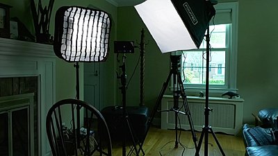

Once you start using softboxes you'll find you can't get that far away from the subject unless you have powerful lights. In most residential situations you just don't have the room to move back far. Everyone has their own preferences but most would agree the closer the better in terms of light quality.
Here you can see my setup for the previous stills that was filmed in my living room. (the light shade was obviously closed while filming). The d-fuse on the left and the Fovitec on the right.

Closer the better for sure in terms of softness, but even with a softbox you start to get the obvious hot spots once too close (forehead noticeably brighter than the face right below it), with the typical overhead angle.
My lights aren't super powerful; they are 1x1 Dracast bicolor panels that were about $280 USD on sale, but even with those I can get decent exposure with them backed off a bit.
Don't shoot in homes too often so yes, cramped quarters are what they are. Mostly stuff I do is in a corporate/office setting.

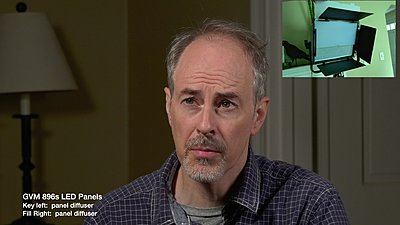

With a proper softbox you don't get those hot spots. Like I said those D-Fuse are too shallow. I get it for corporate jobs that required quick portable setup, you just do whatever is needed and no more. I've found even panel lights with the plastic diffuser is often good enough. Here's a shot with just the plastic panel diffuser not bad compared to a softbox.

Sometimes its all a compromise. Yes the physics are the larger and closer the softer. But it all has to be reasonable. I cant even imagine a subject facing key 24 inches in front of a face.
Keep in mind light rays do not bend, period. So when we talk about soft boxes "wrapping around the face" that is a function of the size and diffusion. We can never bend a light ray, we can only reflect it.
