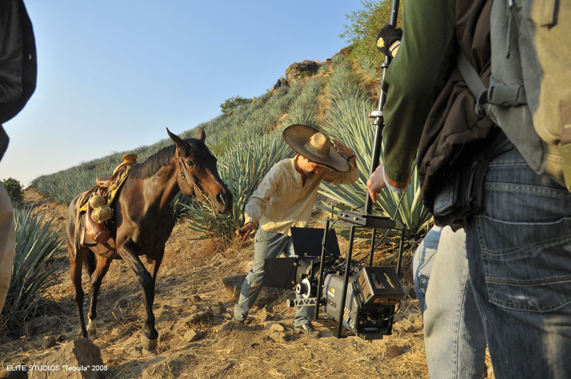

Its nice. The music seems a bit much, but thats how trailers generally are. The pictures look quite interesting. How was the color grading done? I had really liked the look of this picture that was posted earlier and was imaging the movie to be something like this...Nice work!!

We shot the etire project with SI2K cams, we used three of them for almost every scene.
The lenses were Zeiss ultraprimes a set Super16 mkIII for the angulars, and 35mm ultra primes high speed for the teles.
We had seven weeks for the shooting, wich in the case of this production was very little time, some days we need to cover 5 to 8 pages of screenplay, thats why we used multiple camera setups.
The setups where Cam A on a dolly, Cam B on a dolly with a vario jib arm and Cam C was free. The dolly´s gave us the oportunity to have a wider coverage of the scenes, it takes you time to set up, but once you are ready you can shoot really fast.
