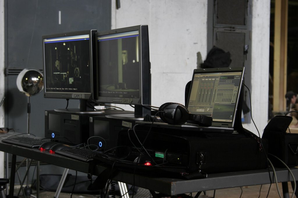

Our first target is to support a small form factor USB device for portable applications where an external Mic/PreAmp is desired for use with a Notebook (or desktop) being used as the video and audio (2-ch for now)recording system.
Here is one device proposed:
http://www.sounddevices.com/products/mx2master.htm
For dual system sound, the "Spoon" team used the MOTU traveller for a dedicated recording system. There was a recent update on their blog:
http://indiefilmlive.blogspot.com/
MOTU does also have a USB version:
http://www.motu.com/products/motuaudio/828/

The 828 works fine having used 3 of them to help record 50 odd tracks of a stage show but it isn't mobile for location recording hence the traveler being so usefull, for what we do it must be 12v and if at all possible have a 4 pin XLR in the side for power, now one small unit we have used in a few situations to great effect for 2 channels is the creative Audigy 2 ZS notebook PCMCIA card, we had some situations 2 years ago on a drama where ease of moving was needed but we wanted to try out using a laptop and the end result was very good considering the cost and it not really being a pro unit or at least advertised as such, I'd have no problem if you had a pcmcia slot in the camera at some time in the future, worst problem really is the lack of xlr's but I'm sure a set of tails strapped to the camera would be fine, after all it's not like we don't do that now with xlr's to a 10pin hirose. I'm not sure of the top of my head though if the creative stuff is only ASIO though and I can't remember if you were supporting that to start with or not.
The sound devices USBpre unit is a great choice btw, I'd have no problems with that being a recomended device to use in a basic recording straight to camera situation.
