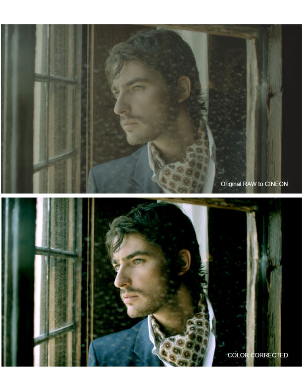

This is a color correction test of a shot taken with the SI-2K.
Here you can see what you can get, in small scale.
This was done totally gerrilla. Natural light situations, i was just testing the art and wardrobe elements and their reaction in the camera.
I`m very surprised with the result, i`ve seen this shots on a Barco 2k projector compared with some HDV and 35mm footage, and it looks amazing

Thats a great looking shot!

Hi Sergio,
From that shot, did you figure out your Cineon conversion issues we were discussing in the CineForm forum?
It looks like you did.

Yes Jason, you and David, show me the light.
