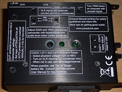

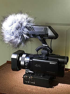

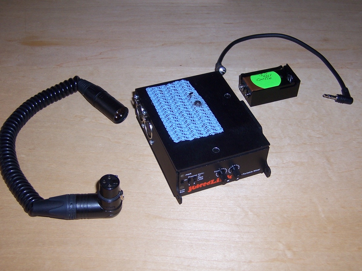

Old December 30th, 2016, 06:35 PM   #1845
Join Date: Jun 2010
Location: Seattle WA
Posts: 1,262
Re: Sony FDR-AX100
Martin - wth regard to question #2, an XLR “box”, one solution can be a JuicedLink unit. JuicedLink has a pretty good reputation for low noise so that is a plus. Also, there are additional controls available such as gain controls for each channel and the XLRs are the locking type.
Review: LVProductionsTools of the Trade: NEW! Juicedlink CX211 XLR Adapter...
This one is the CX211 and can be found used quite inexpensive. On mine, I use a small piece of an antiskid material between the unit and the bottom of the cam so the attach screw dosen’t have to be overtightened. This also protects the typical serial number on the bottom of the cam from getting all scratched up.
The JuicedLink pre really adds to the audio capability of the cam. Separate recorders are also an option but this addresses the question. The middle picture, on the right, is the writing on the bottom of the unit.
