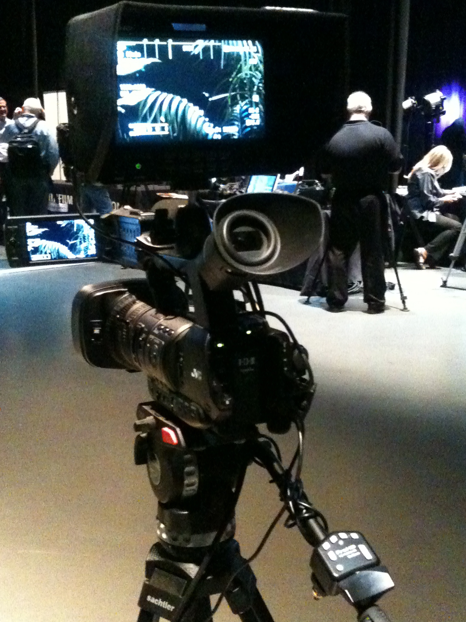

Last week I went to the MTE Media Technology Expo in Seattle to hopefully zero in on, or eliminate, some options, and to gather some more insight. I like being able to use two cams and was thinking along the lines of one smaller cam for portability and "low light" plus a coordinated three ring cam, but probably the same manufacturer for both so they'd (hopefully) have the same bokeh. The Sony X70 is one that I was interested in for the smaller cam so I talked to the guys at the Sony booth. Unfortunately they didn't know how the X70 worked with FCPX.
At the JVC booth the HM650 was set up and it communicates perfectly with FCPX but their HM150, a little brother to the 650, is discontinued and the rep said he didn't know anything about a replacement. "They don't tell us anything" he said.
I called Sony pro tech support (or maybe sales?) and they guy was very helpful about the X70 but when I zeroed in with questions about FCPX workflow he was very apologetic and said he has received a lot of enquiries about FCPX and in talking to him it was very obvious it would help his sales if things worked better. He has mentioned it "to the higher ups."
Based on the financial situation and this sampling of one conversation, it wouldn't surprise me if a better X70 workflow arrives sooner than later. One bummer is my camera light takes the now older style Sony batteries while the X70 has the newer style. Dang.
On the JVC side, I really like their form factor and they've always been a good looking cam, albeit with maybe a quirk or two. When they were acquired by Panasonic and came out with the full hi-def HD7 in 2007, apparently the parent company didn't appreciated being upstaged. Now JVC has been spun off (as JVCKenwood) so it will be interesting to see how it goes. They seem to have some creative engineers but being a smaller company has it's advantages and disadvantages.
Picture of the JVC HM650
