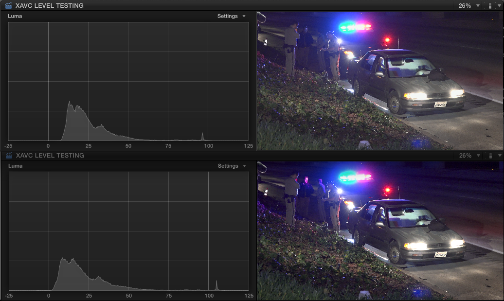

I have posted about a level shift I have been having when transcoding XAVC to ProRes in Catalyst Browse. This issue never happened when ingesting AVCHD directly to FCP X. Well, I did some investigating to try to figure out why this is happening.
I rolled off color bars in XAVC and AVCHD, then transcoded both to ProRes in Browse, selecting a separate export for no color adjustments and for all color settings, just to see if that makes a difference. For reference, all my previous off-level transcodes were to ProRes LT with the all color settings selected.
Well, after transcode and ingest into FCP X, all the files look not only proper leveled, but all identical. I then repeated the test with a scene shot through the lens, but the same thing, all looked fine. So I went back to my old project from yesterday with the odd level, and Catalyst/transcoded one specific file. Sure enough, the newer transcode looked perfect, but the old one still had the same odd levels.
This makes no sense to me, as both the old file and the new file were transcoded with the same settings in Browse. I am including a frame grab so you can see the huge difference in levels. The old transcodes are seemingly compressed. Just a warning to look out for this in your transcodes, as there are really no settings in Browse that can or should change these levels, so obviously there is some strange issue present here that may pop up for someone else.
Paul

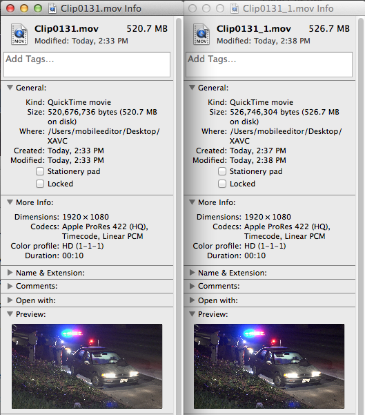

Found the problem. I reingested (batch) all clips in batch mode for the story that the above clip came from. Problem reappeared! I then retranscoded the same clip back into this newest project in FCP X, and the problem disappeared again!
This appears to be a definite issue with the new BATCH CONVERT function in Browse. I am including a screen grab showing that even the file size for the two clips when ingested individually and in batch are different sizes.
I also tested this using the PC version, which only transcodes to XAVC Intra, as well as on my Mac again transcoding to XAVC Intra instead of ProRed. This issue exhibits itself on both platforms on ProRes as well as XAVC Intra in BATCH CONVERT. Individual file transcodes are not affected on either platform. Forwarding this concern to Sony, so that we can begin batch transcoding and editing our XAVC L footage by sometime in 2017. :-\
Paul

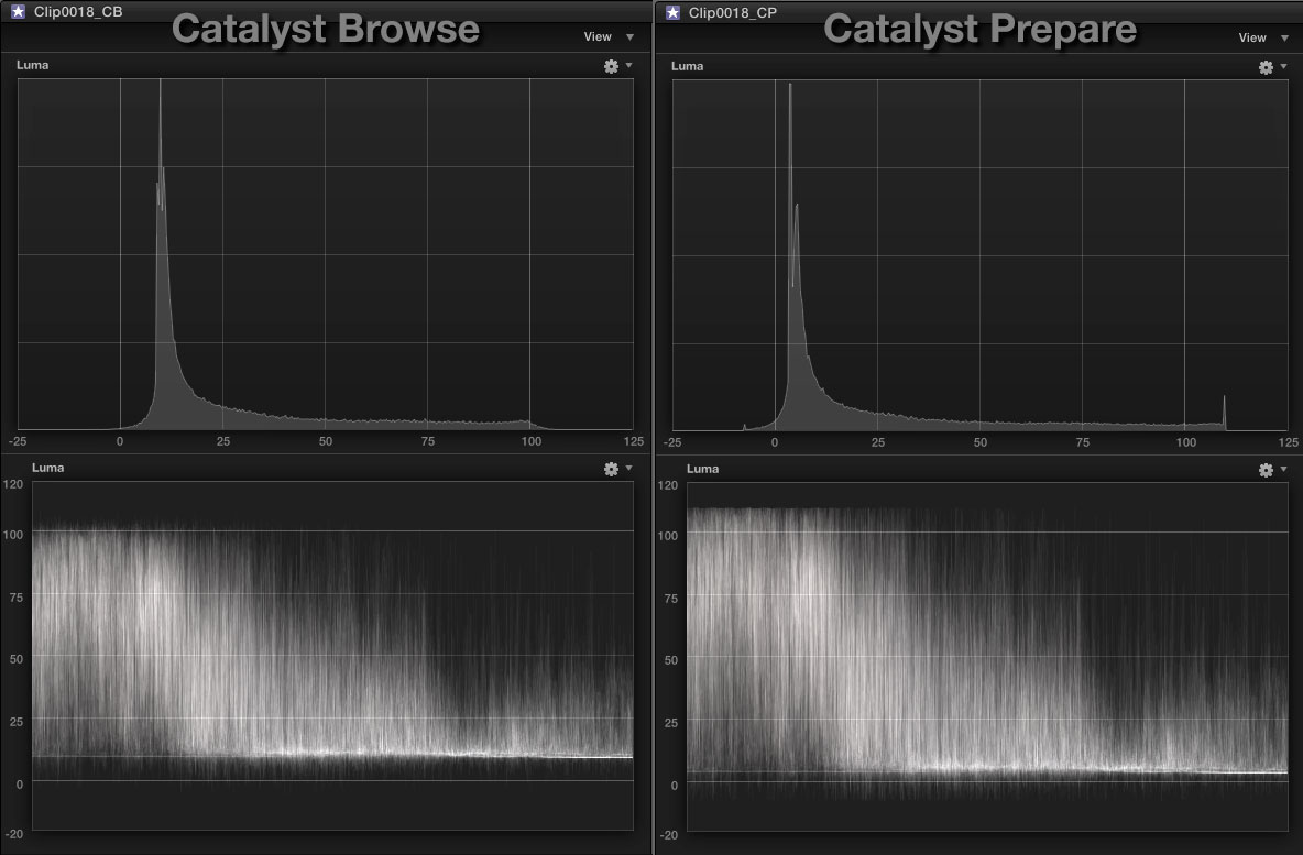

I just started the trial of Catalyst Prepare. I don't have the X70 yet, but am working with a sample XAVC-L 1080p/29.97 clip.
The trial software included Browse and Prepare (both at version 1.2.0).
Didn't use batch, but in transcoding this single clip to ProRes LT 1920x1080 29.97, Browse exports something different than Prepare.
Also, selecting 'Include Color Adjustments' vs. 'No color' made no difference at all.
Here are my findings:
Both exports from 'Browse' results in a slightly flatter looking image. Each file identical in size (409,611,960 bytes; 409.6 MB).
Both exports from 'Prepare' are not as flat. Each file identical in size (403,922,920 bytes; 403.9 MB).
As to the color vs. no color, not sure what's going on; could be that there's no 'data' there and thus both settings are producing the same output.
Resultant bitrate of the ProRes LT was a tad higher as produced by 'Browse' (107.33 Mbps vs. Prepare's 105.84 Mbps)
Ricky Sharp is offline   Reply With Quote

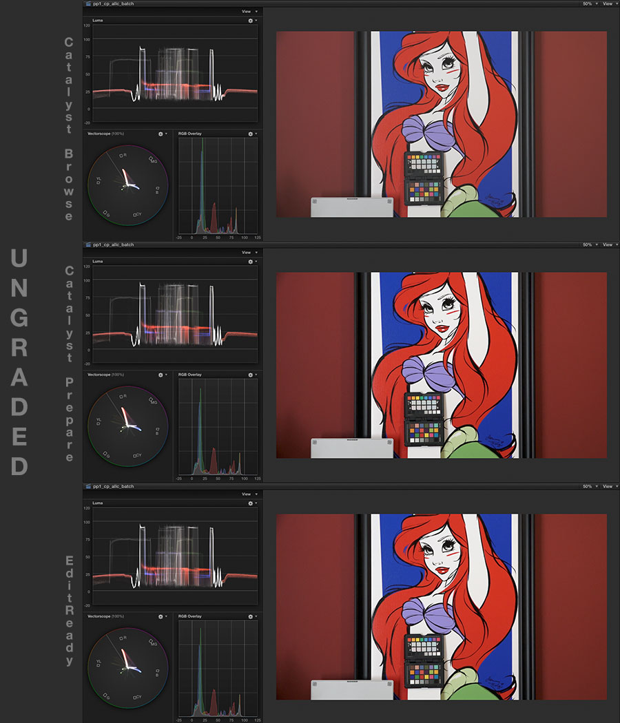

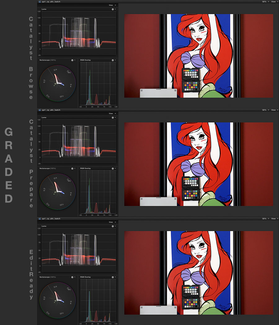

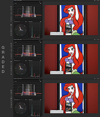

Performed an exhastive test today with factory Picture Profile settings on my X70.
Recorded 6 clips of the same subject; PP1 through PP6. White balance was set to manual (dialed in to 3200 K as confirmed by my EOS 6D and white balance card). At the end of the shoot, actual white balance increased to 3300 K (while office lighting was primarily used, some spill from closed blinds came into play). But that small difference shouldn't be noticable.
Software: Catalyst Browse, Catalyst Prepare, Edit Ready.
Original codec: XAVC-L 50 Mbps, 30p
Transcoded codec: ProRes 422 29.97p
Permutations: Batch import, individual import. For CP and CB, also did imports with 'No color settings' vs. 'All'.
For a given software package, I found zero differences in levels between batch vs. individual imports.
CP and EditReady produced transcoded clips with identical (to the eye) levels.
CB consistently produced transcoded clips that used flatter levels. For the following images, I used PP#5 as that produced the most accurate colors (what my eye saw). This first image shows ungraded ProRes footage. Note the flattened levels in CB. The second image are shows graded footage. I was able to match (to the eye) each image. But of course had to stretch the CB footage more.
Is this the same levels issues as others are seeing? I'm assuming I'll want to purchase either CP or EditReady as they produce levels closer to what the actual camera captured (I monitored the histogram in camera to get a proper exposure)
While I don't see any issues in this particular clip, I believe by pushing levels more in the CB footage, I increase the possibility of banding.
