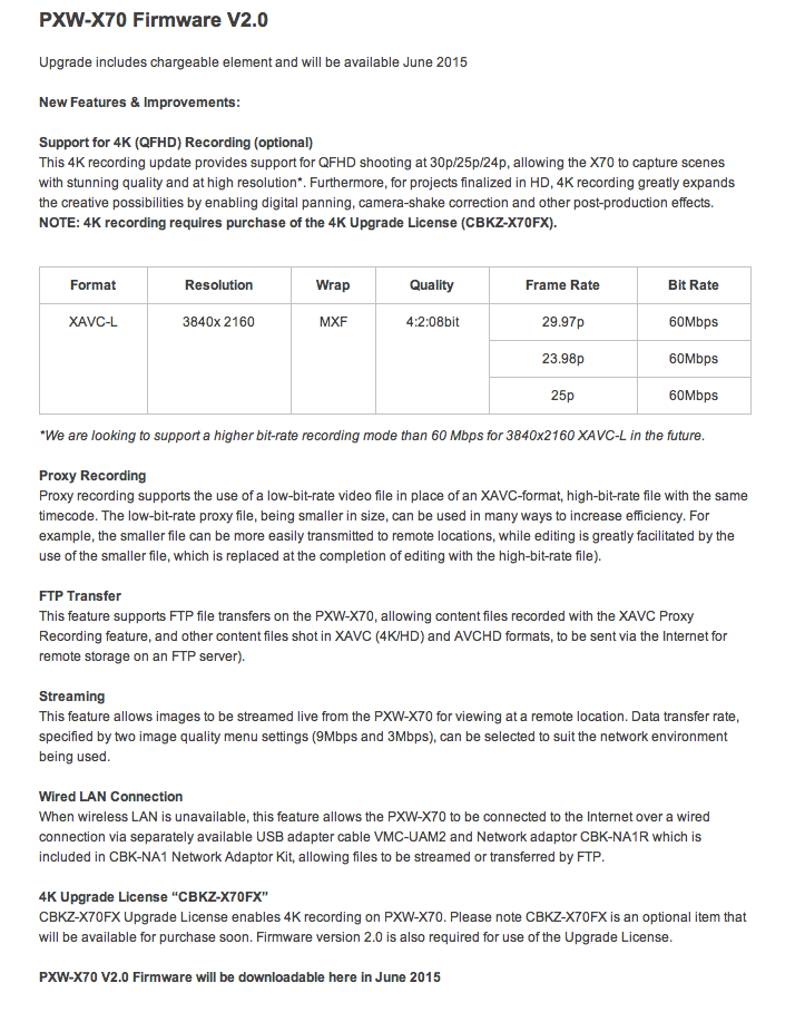

And 4K will be 4.2.0 at 60Mbps only in June 2015 - but there is a little note that says they are "looking to support a higher bit rate in the future"....More stalling for time...
Think I will definitely pass on the X70 now - but will give it a good hands on when I am at BVE tomorrow.
Note: Currently the official Sony UK link is very busy/won't often load as it includes some interesting FS7 (and other cameras) firmware update information too.
EDIT - Adding official link below:
New firmware for broadcast and professional A/V equipment from Sony : United Kingdom : Sony Professional
Also, adding a screen grab of the relevant info on the X70 too.

Looking at those numbers, time frame, price, It makes it a lot easier for me to wait until NAB to see what other manufacturers are doing. That and the lack of FCPX plugin for XAVC-L does not give me confidence in Sony's support for its cameras.

So we have to wait til June, for the SAME 4k mode as the AX100.... and then pay extra for it??? That's our reward for buying the more expensive camera? That's just a disgrace.
I still totally rate the X70 as an HD camera, but for 4k... this is an insult. They would have been better off not bothering.

Also, a short while back Sony announced that the AX100 was going to get a free 4K 100Mbps firmware upgrade this Spring…if that's still on the table then it puts this X70 announcement (re sticking with 60Mbps with their 4K offering in June) even more to shame!!!
