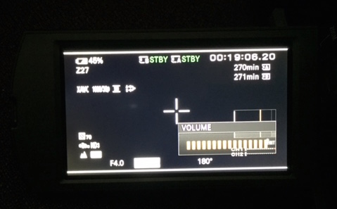

Originally Posted by Jeff Harper View Post
Ricky, the meters are not obscured when adjusting audio manually no matter what your audio source, at least not on the AX100. I have a quick access button set for audio and adjust it all the time whilst recording, works like a charm.
Should have actually tried that before I wrote :) On the X70, the level adjustment box (at least for internal audio) does obscure the level meters a bit. The bottom edge of the channel 1 meter can still be seen though it's right up against the yellow level value). And the outer edge of the level meter box cuts right through the middle of channel 2. I could see that as being annoyinging difficult at times.
Perhaps Sony can move up the audio adjustment box. Or, make it not as tall.
