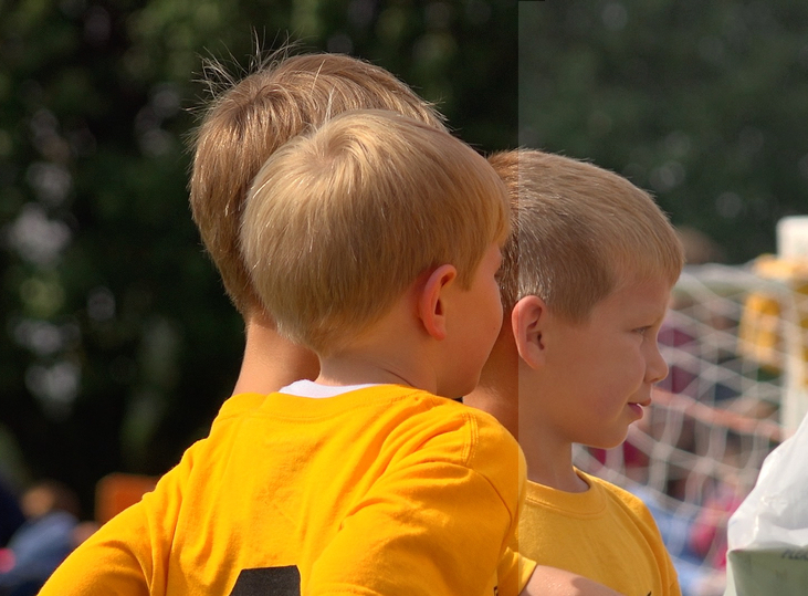

This also shows the shallow DOF possible even on a sunny day with the 1 inch sensor: lens is wide open (required using 0 or -3 Gain and ND1 or 2 to do so), 60p, 125 Iris, about 15 feet from subjects, zoomed in quite a bit, trees and soccer net in background are pretty far away. This was handheld (active stabilization), 1080p, was just a still frame exported from FCPX then resized to half size. Obviously the right part of the frame is the ungraded out-of-camera look, with the left part after simple grading in FCPX to get a more saturated, warm, sunny look.
I don't really see many others shooting flat like this with the X70, so if you figure out better settings than these please pass the findings along! Hope this helps.
