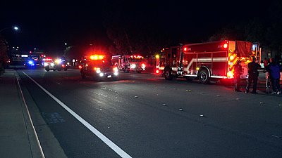

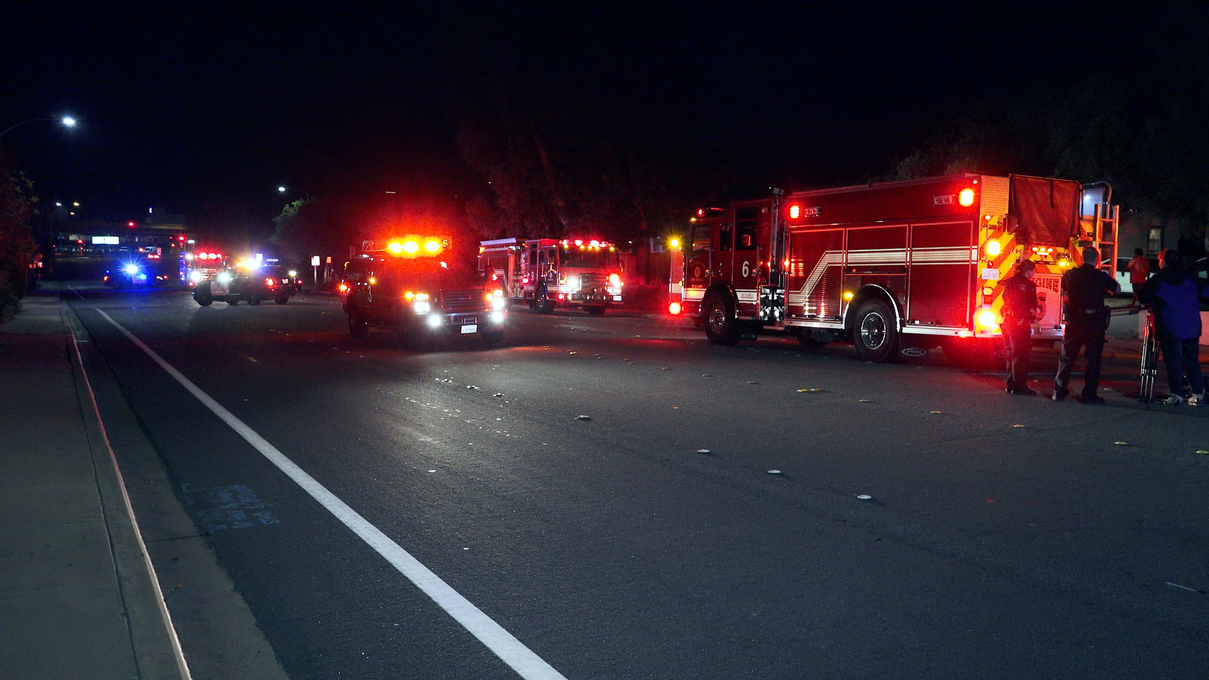

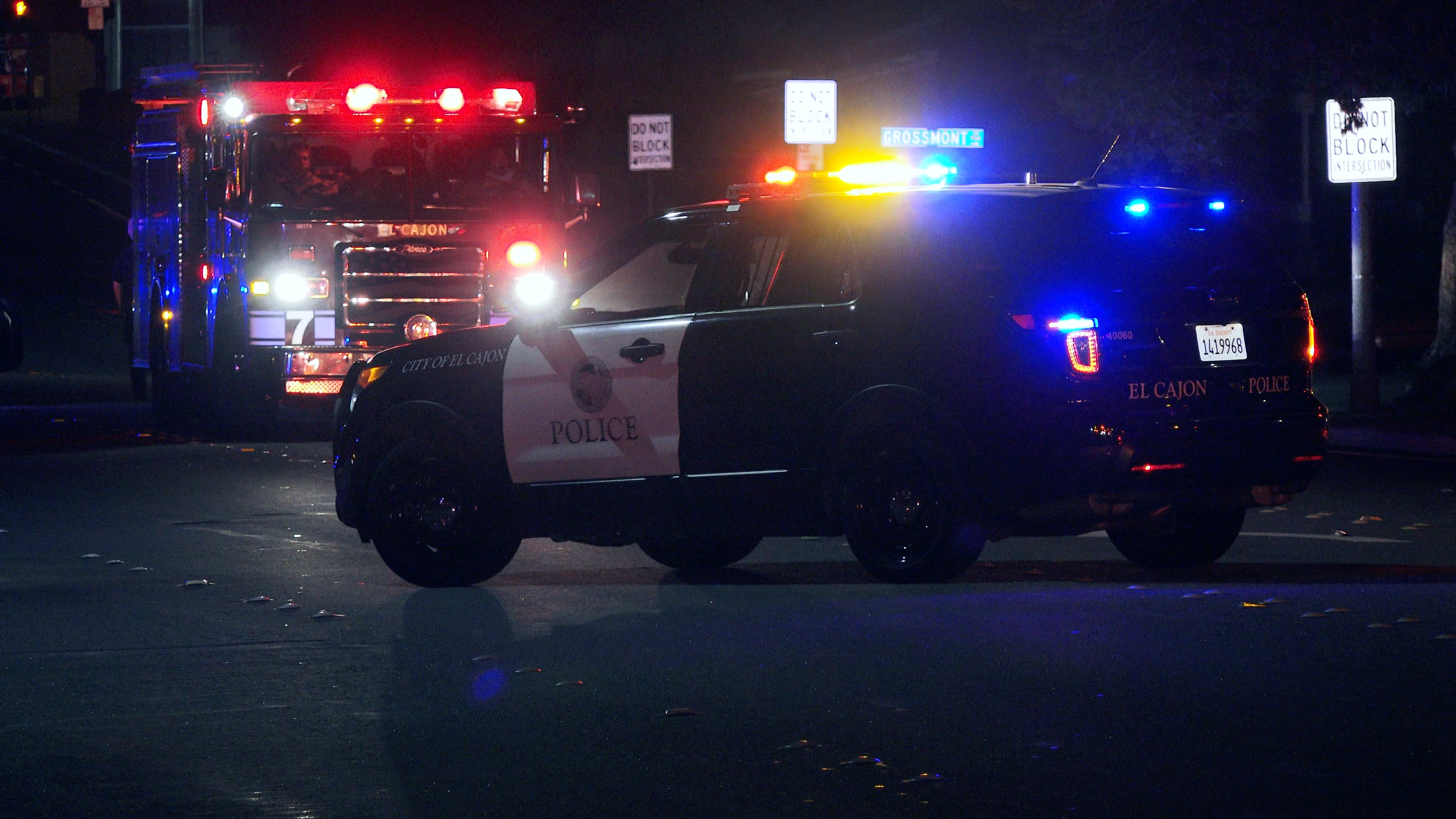

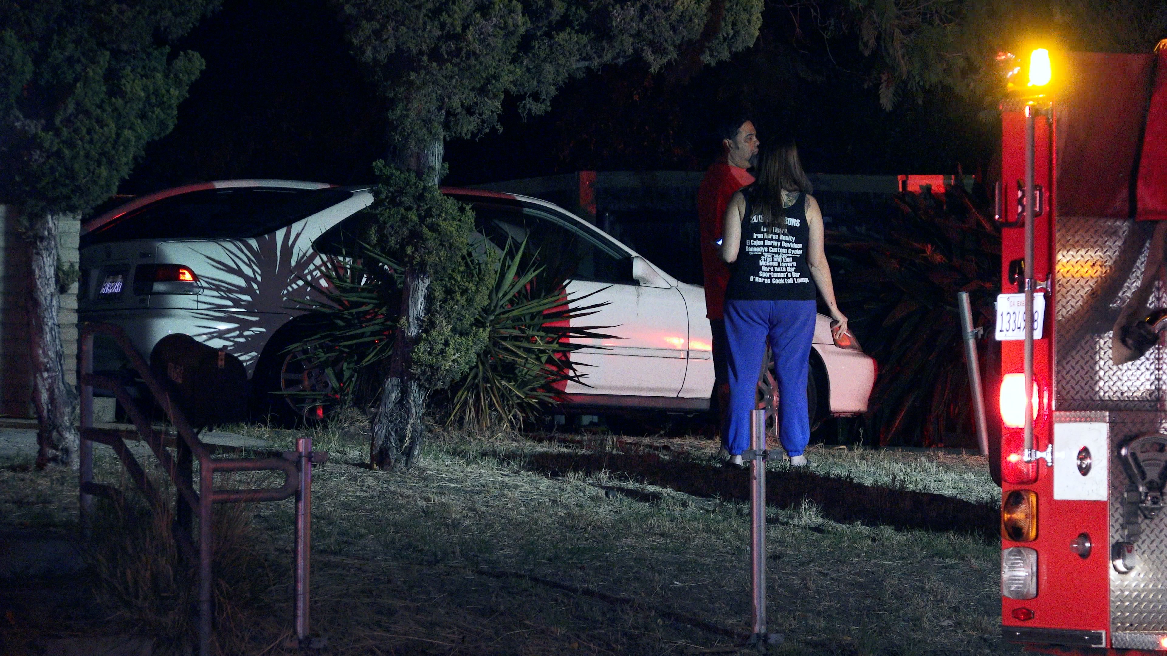

So, with lots of light, 1080p FHD exports from my X70 4K raw footage looks ULTRA SHARP, and pretty. At the high gains I shoot normally though, 24-33db, the 60Mbps codec simply isn't capable of handling the noise, and marco-blocking runs rampant. A little grading makes things like red fire trucks lit by red LED's simply swim in little wiggling blocks.
So for now, I guess I will be sticking to HD, and continuing to wait for my $300 rebate on my 4K upgrade. It is also notable that 4K to 720p is not a pretty downconvert. Also, on FCPX 10.2.2, X70 60Mbps 4K video HARD CLIPS at 100IRE. If you skim the timeline, you will be able to look at 100-109IRE on the waveform, but the moment you stop, it hard clips again. If you want 100-109IRE usable in FCPX, you need to batch transcode to XAVC L or i using Catalyst Browse, which when ingested into FCPX will give you access to 100-109. :-)
A few 4K high gain still frame grabs.....click for full UHD resolution......everything wide open iris.
