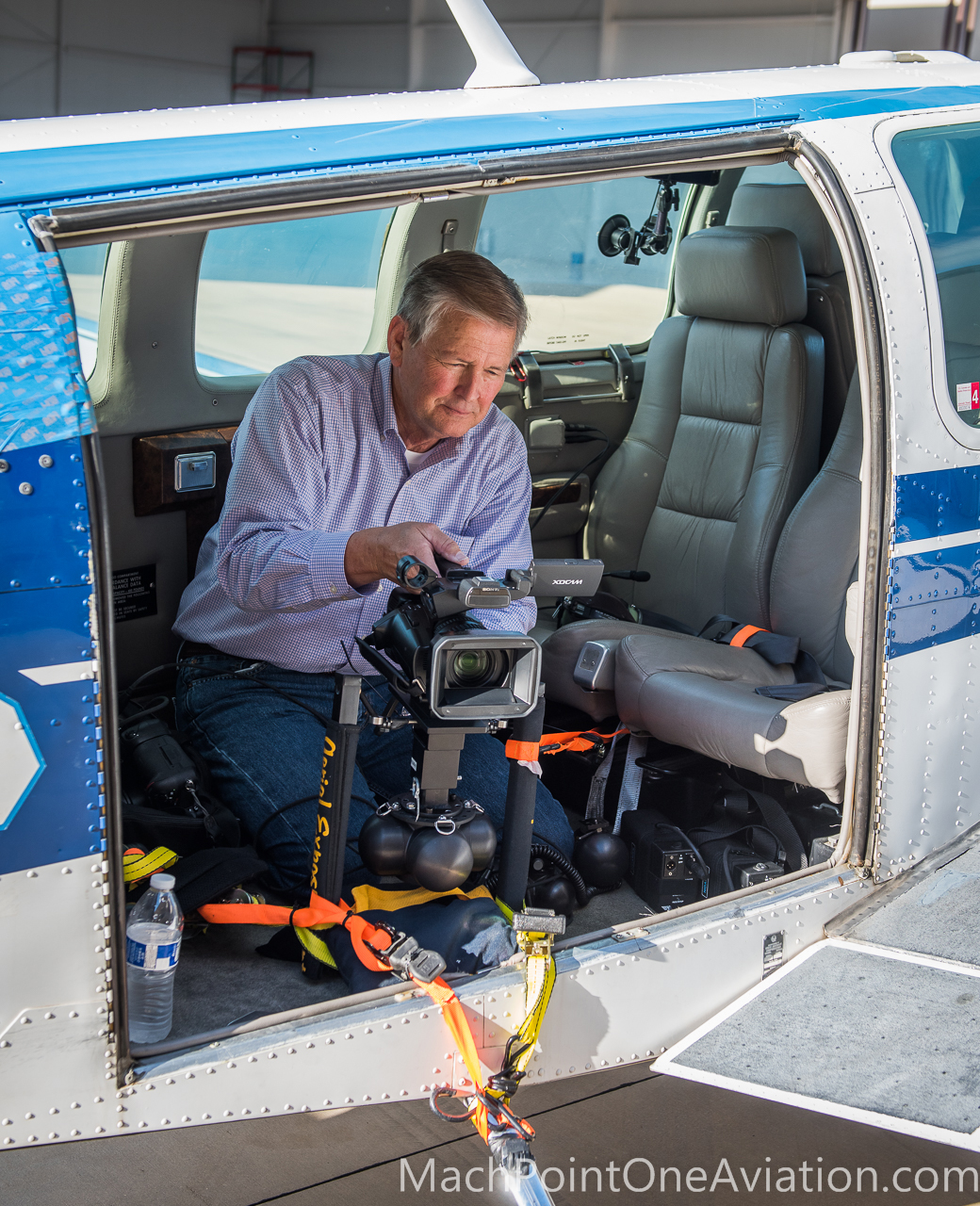

Normally I wouldn't take a new camera out of the box, charge the batteries and immediately put it to work, but I went out on a limb with this new camera and I'm very glad I did. The menu is very similar to my X-70 and my FS/7, the form factor and general control placement felt good so I decided to roll the dice.
My experience in this industry pales in comparison to most of you here so it is no try intent to contradict anyone, but I love this camera so far. I'm digging into the footage from my first assignment with it and will have some clips for you to look at in a day or two. The shoot was challenging, as always, with lots of moving parts and changing light. The Z-150 performed wonderfully, and I'm pleased that I made the investment. I have a mint X-70 with a Samaurai Blade and extra batteries for sale.
Here are some stills to set the stage.....
PXW-Z150 first impressions-img_4454.jpg   PXW-Z150 first impressions-jwa_5361rt1acweb.jpg
Jim
