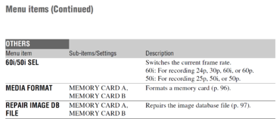

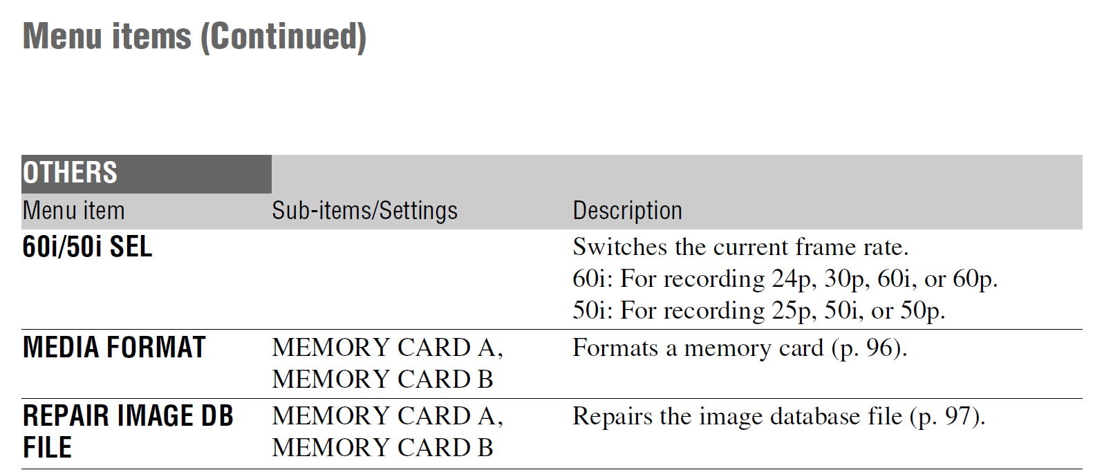

Nick,
The camera does not record S&Q in interlaced, it's all 1080 progressive.
You are in PAL land, so when you get this camera, you would go into the menu system and under OTHERS, you would have a choice there of 50i or 60i. For PAL, you select 50i.
This selection will determine the choices available for several other menu items, including S&Q. Once you have chosen 50i, when you go to your S&Q menu, you will have a choice of recording either 25P or 50P in XAVC HD or AVCHD formats, or 25P in MPEG HD 422 or MPEG HD 420.
The camera is going to actually shoot at 100fps, but then roll that into a slow-motion format per your recording mode choices. So if you were to select something with 25P, you would see a 4x slow-mo on playback.
If you had selected 60i in the OTHERS menu, the choices would be a little different, and it would be at 120fps.

This is a world camera, but you just have to choose in the menu 50i or 60i to go between PAL or NTSC.
If you are shooting S&Q mode in 60i mode (NTSC) you get a choice of 24P, 30P or 60P in XAVC HD or AVCHD formats, and 24P or 30P in MPEG HD 422 or MPEG HD 420. Aside from the S&Q mode, the format and frame rate choices are abundant.

I'm confused by your statements that seem to be at odds with each other.
Originally Posted by Nick Fotis View Post
I *think* (but I may be wrong) that you cannot have both 50 Hz and 60 Hz modes in the same body.
I find it irritating that Sony didn't build a world camera.
It's all Greek to me :)
