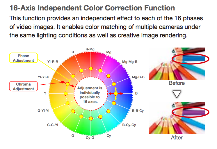

The attached pic demonstrates what that Panasonic can do that the X70 and Z150 CANNOT. The color correction menus for the X70 and Z150 allow adjustments of only 2 colors. The UX180 allows adjustments to 16 of them!!!!!

Yes much more adjustments than on my Sony's. I look forward to some reviews when it comes out later in the year. Could definitely be a replacement for my NX5U and/or my FDR-AX1.
