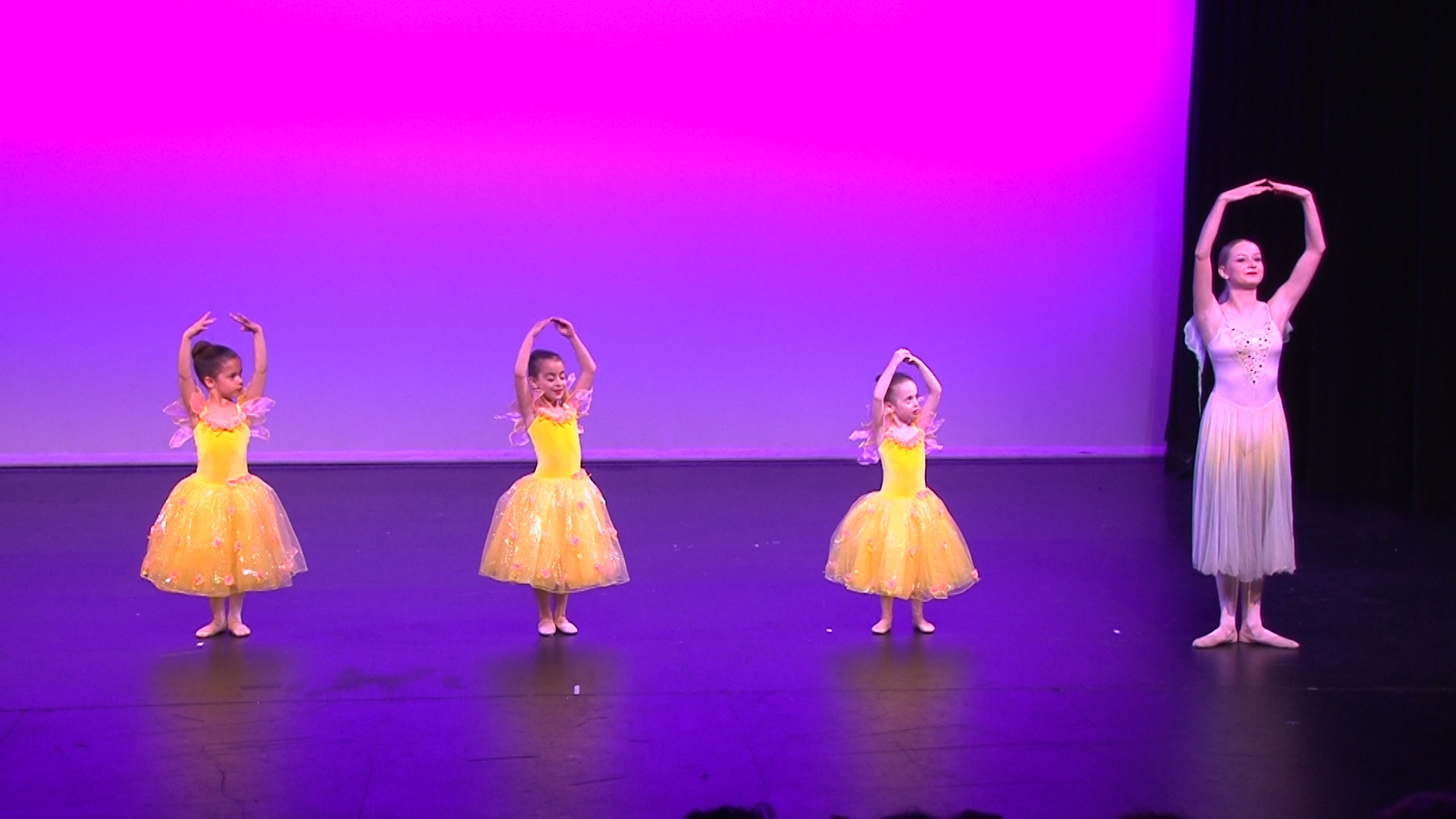

I shot with the NX5, I set the Z150 up to record the same show in 4K as a wide shot for a test, to review what it looked like later. Here's a still from the NX5:
http://www.dvnonstop.com/pxw-z150/20...5.Still001.jpg

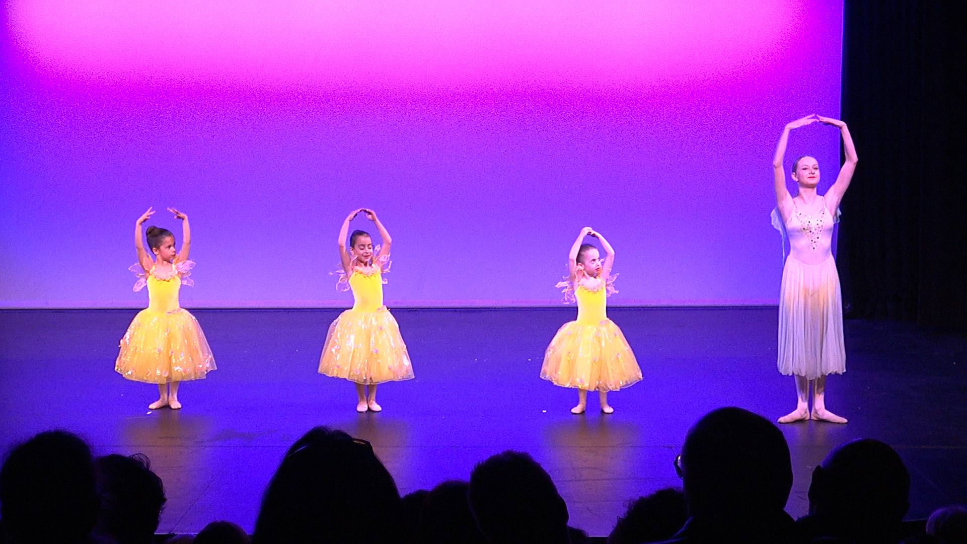

Obviously I was zoomed in on the NX5, here's the same frame extracted/cropped from the 4K recording:
http://www.dvnonstop.com/pxw-z150/Cl...ll001_Crop.jpg

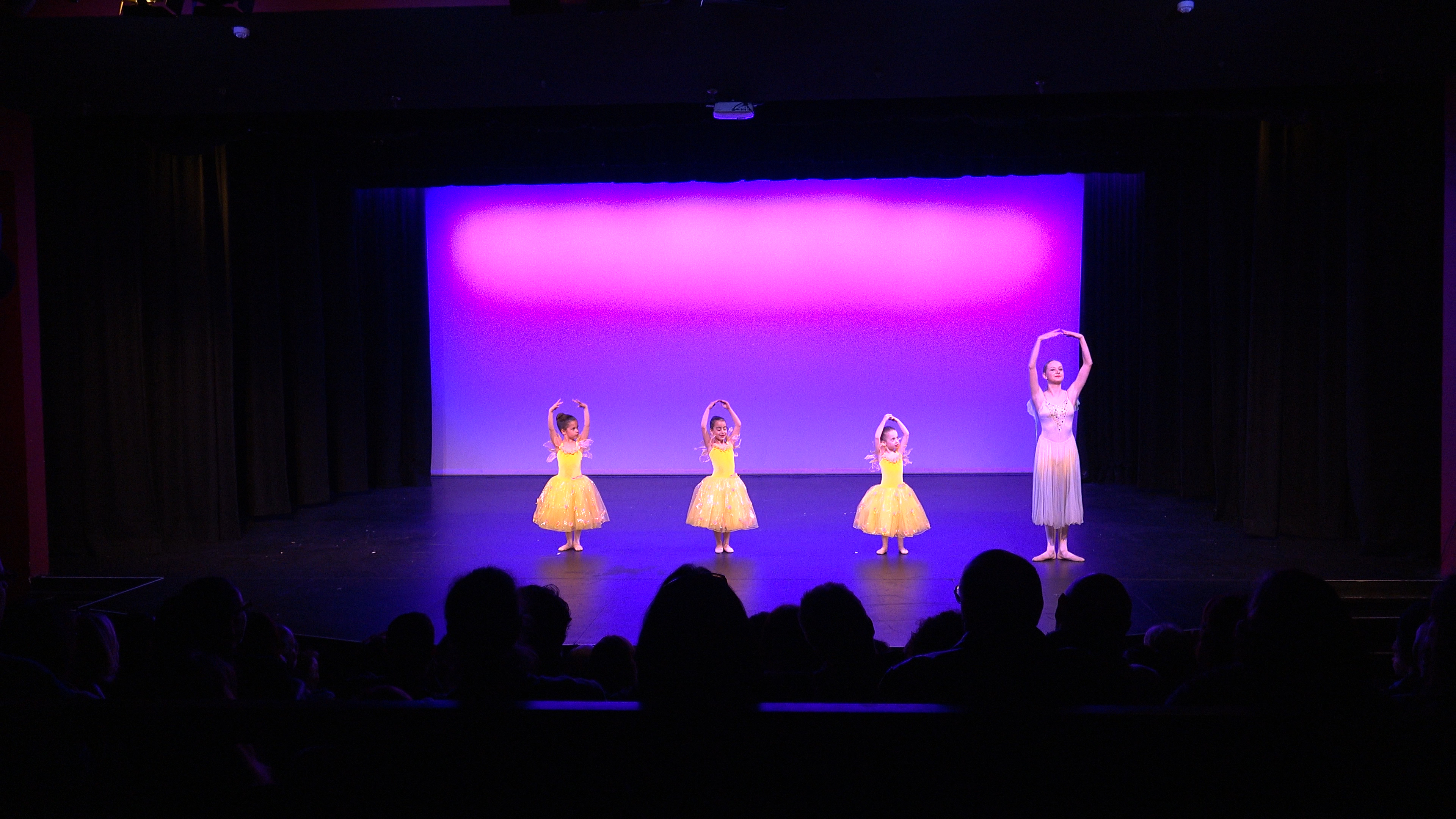

Here's the original Z150 full frame wide shot for reference:
http://www.dvnonstop.com/pxw-z150/Cl...7.Still001.jpg
The NX5 was f3.7, no gain, shutter 50, focus 12m, white 4400K.
The Z150 was f2.8, 6db gain, shutter 50, focus 10m(?), white 4400K.
(The Z150 manual focus stops were 10m, and then 20m, nothing in between? The subjects in the shot are standing on marks at 12m, the stage was between 8m (front) and 17m (rear) from where I was).
I had read through various articles about the Z150 in low light, I was still surprised I needed any gain at all for stage lights. Looking at it now, I do think I had the gain a little high (I set the camera up before the show started, and couldn't adjust it during). Even so, there is a LOT of apparent noise to me in the Z150 image - which is historically what I would have expected on older cameras once you start ramping up the gain. But I've seen various examples on this forum from other Z150 shooters, without the same level of apparent noise. Please someone tell me I'm doing this wrong? I can see see there additional picture profile settings to the NX5, I'm hoping there's something in there I haven't learned yet that will help, but I'm still somewhat shocked that the Z150 apparently needs so much more light, compared to the much older NX5.
