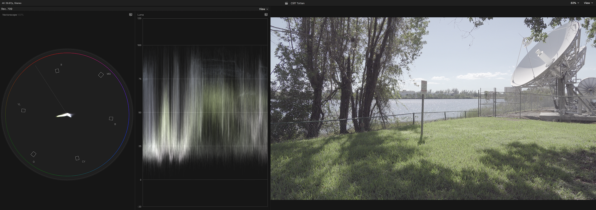

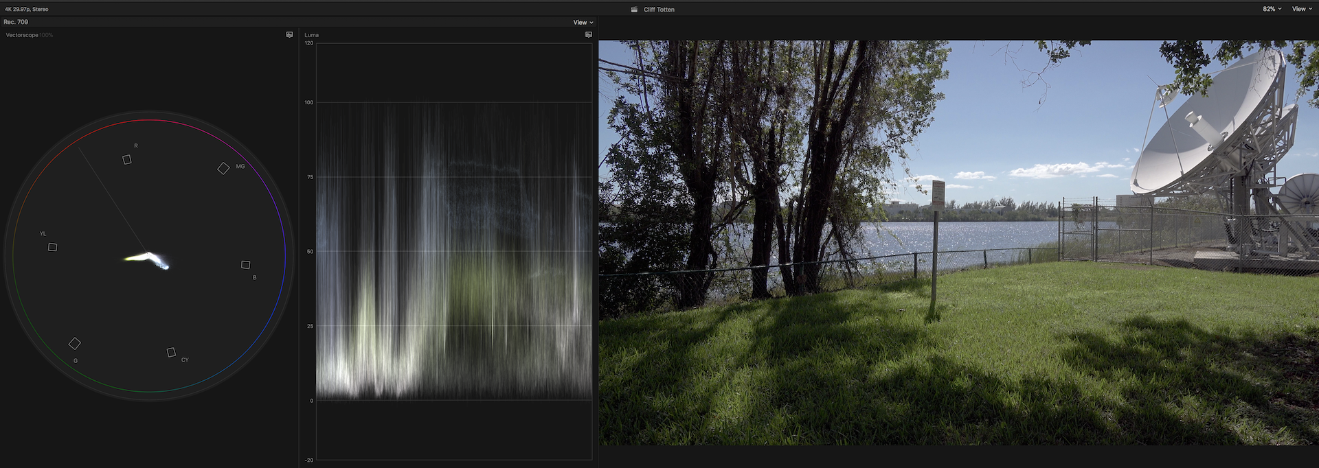

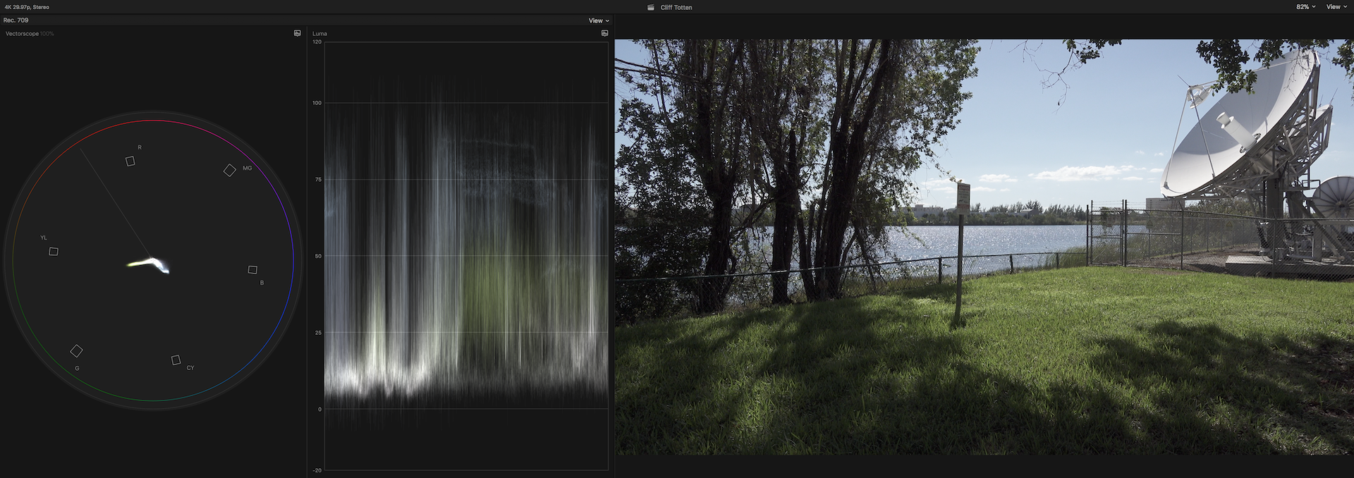

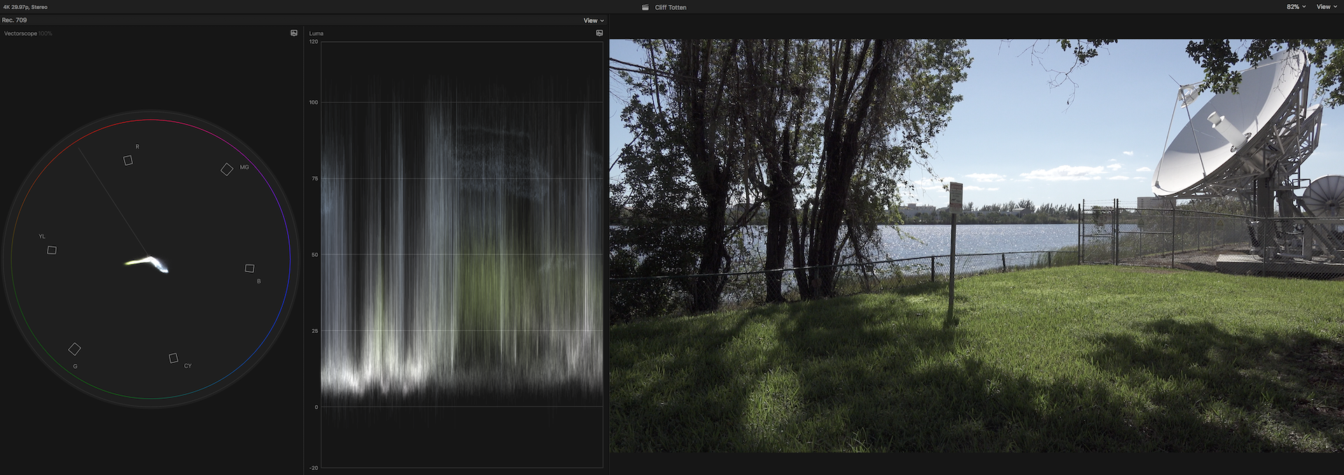

Just a quick look 1t Cliff's clips as I see them in FCPX 10.4 with scopes and the S-Log 2 clip quickly graded in CoreMelt Chromatic
Introduction to the Z90, NX80, and AX700-clip-1-copy.png   Introduction to the Z90, NX80, and AX700-clip-2-copy.png
Introduction to the Z90, NX80, and AX700-clip-3-copy.png   Introduction to the Z90, NX80, and AX700-clip-3-quick-grade-copy.png

I'm sure most of us know this but for anybody that doesn't, on Cine 1 vs Cine 2 and SLog-2 on the scopes:
SLog-2 actually allows for 109 IRE. It's not broadcast legal. (there is no reason for that anyway)
Let me see if I get this right from memory... 8bit values for broadcast are 0 to 236? This takes you to 100IRE. However, 0-255 is 109 IRE and that is the full 8bit sampling range.
Technically, 8bit depth capability is 0-255 but when we shoot under boradcast legal, we slice anything over 100....so we are using a high of 236 instead of 255 so that's "7.5" bits instead of the full 8 bit ? Hehe.
Cine1 also goes outside broadcast legal to and Cine2 stays inside at 100 IRE clipping.
Did I get that right? ;-)
