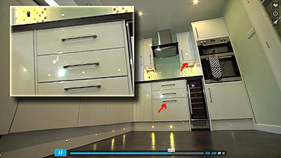

I've recently had a new kitchen fitted so I picked up my A7s and filmed a bit to send to the designer so she could see how her plan worked out

Why is there so much aliasing artefacts? Did you use fulframe mode with 50P?

Yes full frame @ 50p - downsized to 1080X720 6Mbps target I'm not seeing many artifacts?

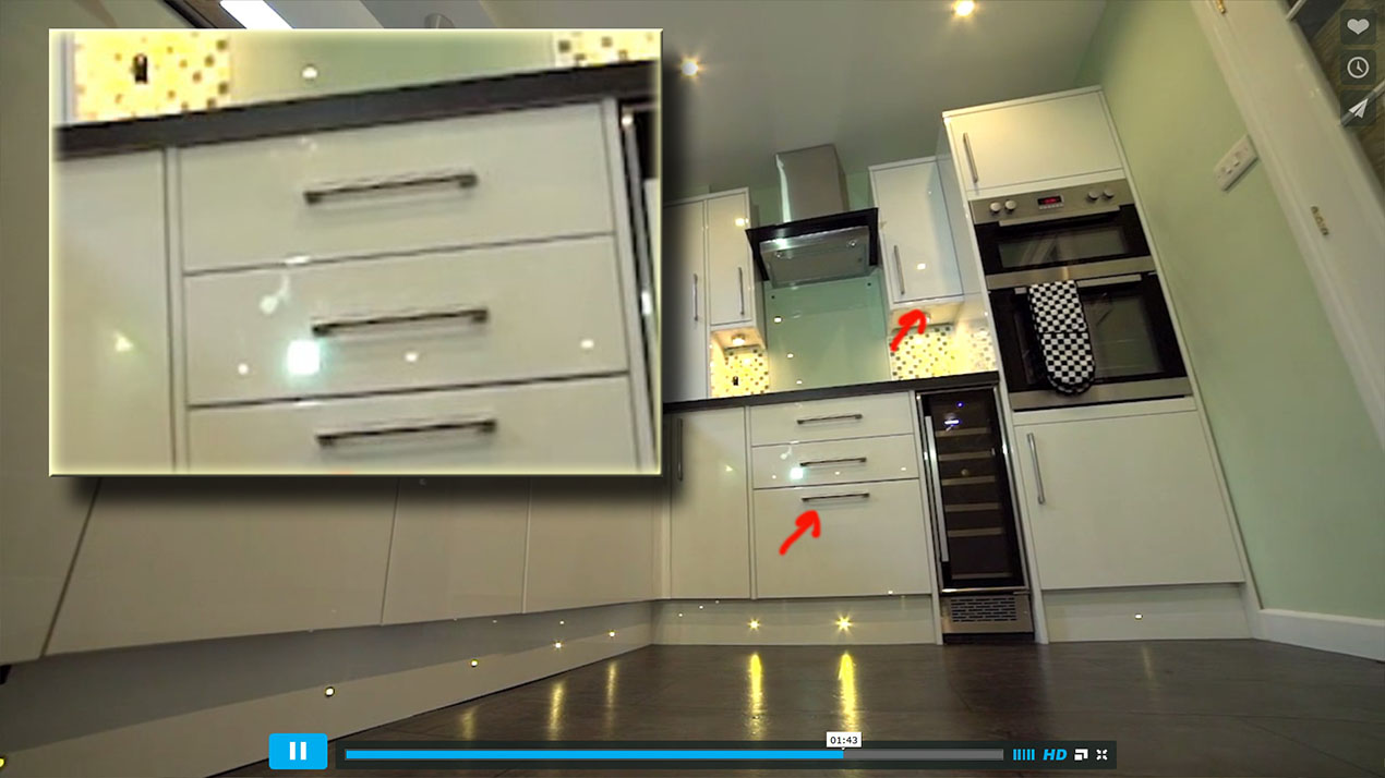

Take a look at the door handles. They are living in most shots.
Avoid to use FF at 50P. Its a mode, that can`t (like 120P) make use of full sensor reading. Its terrible compared to FF in 25P (or APS-C in both 25P and 50P). 25P has a clean - perfectly detailed sharp picture absolutelly free of moire and aliasing.

You have to use crop mode if you are using 50/60P or you will get that horrendous aliasing. Or.....just shoot organic soft BG subjects that don't have a lot of fine detail. Then it works.

This has nothing to do with cropping. Its the method for downscaling from 12Mpx sensor to needed 2Mpx for HD picture. A7S use ‘direct pixel readout’ utilizing the entire width of the full-frame image sensor without line skipping or pixel binning. Therefore in both HD and 4K 25P video acquisition it can read and process data from every one of the sensor’s pixels.
50P have to be twice as faster... and this is probably not possible at this technology level.
There is 50P - but only at the "old school" technology level. The some for 120P.
APS-C is smaler and can be read faster - so its at the best quality in 50P too.
