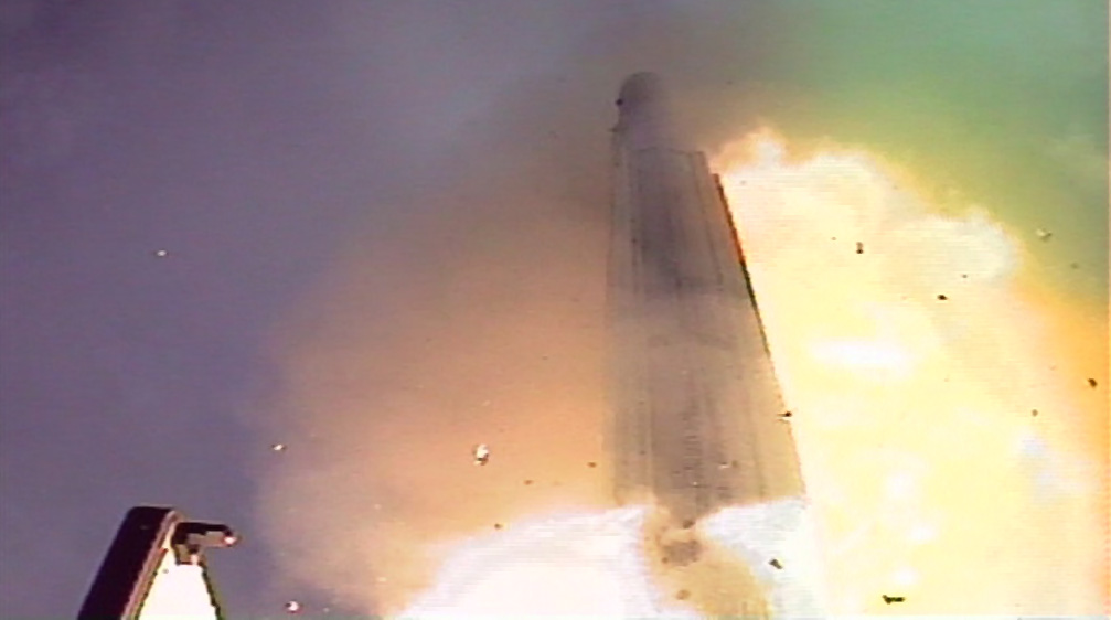

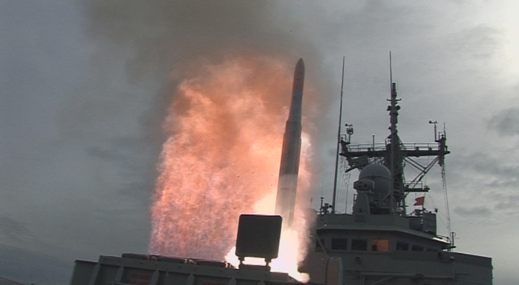

Below are two frames at 1/10,000 of a second plus one from right under a missile. The purpose of this shoot was for analysis so high-speed shutter and frame rates were the order of the day.
Chris Young
a7s iii and S-Cinetone Test Video-hmas-sydney-essm-launch-20.08.07-cam-3a.jpg   a7s iii and S-Cinetone Test Video-hmas-sydney-essm-launch-20.08.07-cam-3c.jpg
a7s iii and S-Cinetone Test Video-hmas-sydney-essm-launch-20.08.07-cam-5a.jpg
