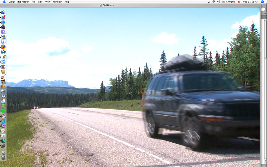

I'm working on my 4th program shot with my 350 and am having a very strange strobing problem on import into FCP.
Look at the attached photo.
This is how the footage looks after import, and for that matter exported back to disc. When playing back on the monitor after export, the strobing is quite noticable on the big screen.
BUT, put the master disc in the machine, and it plays just fine. No strobing whatsoever. Lovely, beautiful video.
But import it into the Mac, (FAM/XDCAM Transfer) and it does not matter if it is on the timeline in FCP, or just the computer playing it in Quicktime Player, the strobing is there.
I've used other footage from this trip in another program, and it looked just fine. I never changed the camera settings in the trip.
I'm shooting 1081/60.
I had thought that perhaps it was a shutter issue, but again, the original plays just fine camera into monitor. But I have this nasty habit of wanting to edit my footage, and that is where the problem comes in. Any and all help is appreciated.

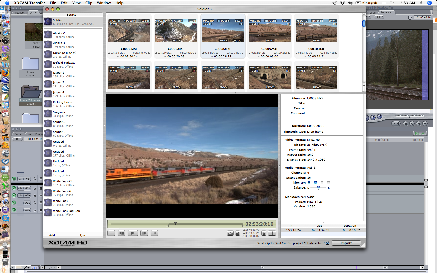

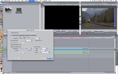

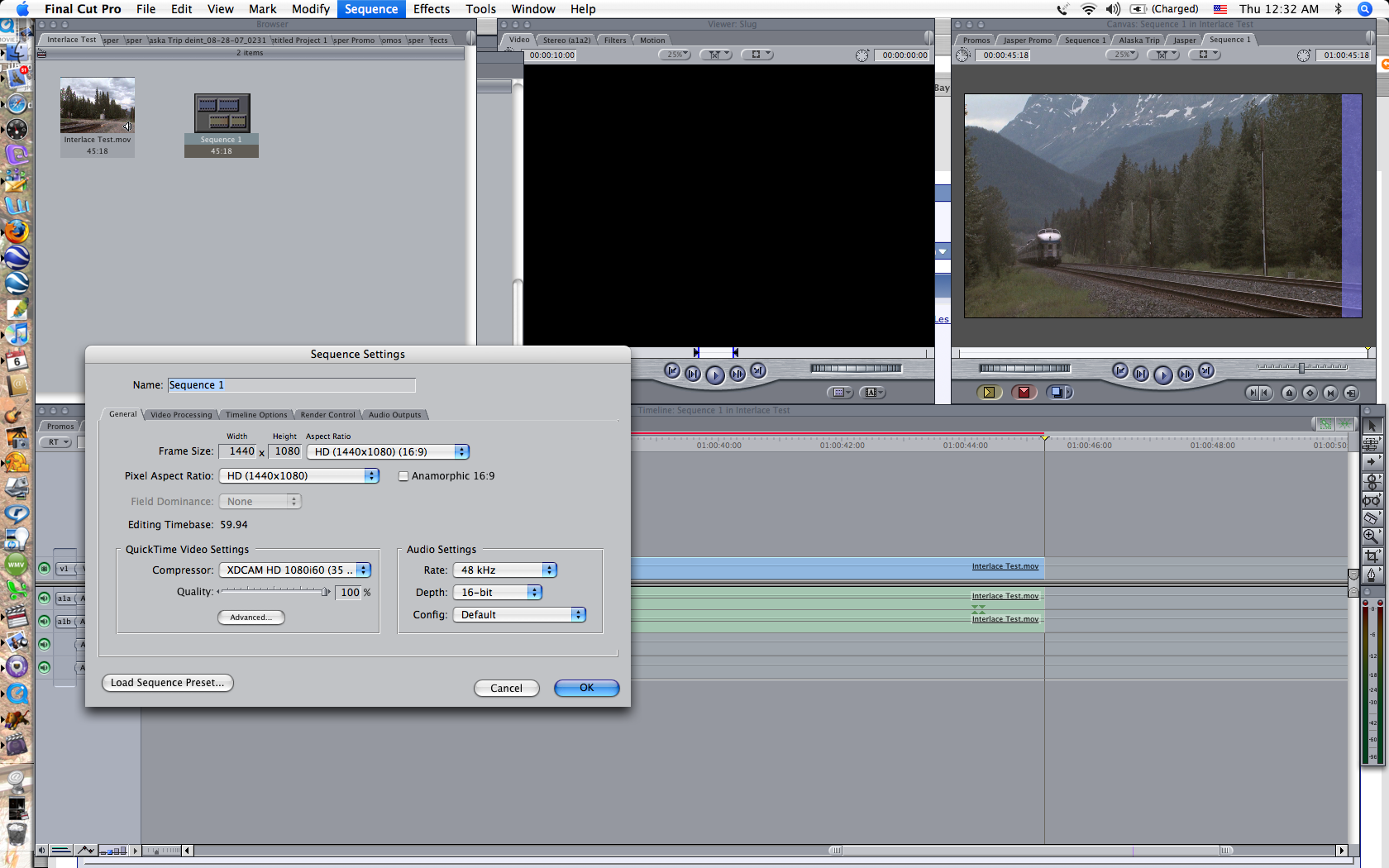

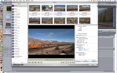

OK, here's what seems to be happening.
In a nutshell, the clips are importing at 29.97. The problem is, they were shot in 59.94i.
In XDCAM transfer, the frame rate clearly says 59.94i.
I've attached several screen shots so you can see what I am looking at for yourselves, hopefully it will be helpful.
As you can see, I'm importing everything at 29.97.
What about export?
I took a clip, and just to be sure, in Compresor, I converted it to 59.94i.
Dropped it into my FCP sequence that I have pictured. Tried to export to the camera. Got, "assertion failure: valid media time scale".
The camera is set at FAM, 60I, HQ. Just to be sure there, I tried exporting back to the disc that the the original files are on. The originals are at 59.94, and I tried to export back that way.
The camera is only accepting clips at 29.97. 59.94 gets the assertion failure.
This one has really got me stumped. It's late and my brain may be dead, but I just can't figure this one out? Should not clips shot at 59.94 import at that rate? It would seem I've changed something in FCP, but I don't know what. Any thoughts?

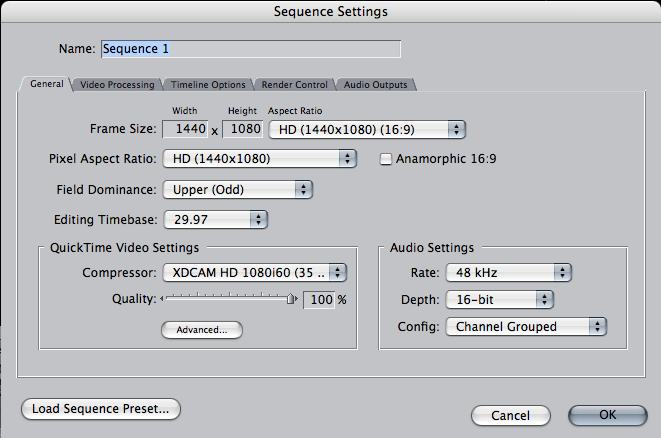

Join Date: Oct 2002
Posts: 2,100
Les,
29.97 and 59.94i are two ways of saying the same thing. They both mean 29.97 frame rate, interlaced.

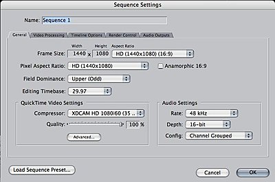

The problem lies in that when you change the editing timebase in the FCP sequence settings to 59.94, FCP is thinking 59.94 FRAMES per second. 59.94i means 59.94 FIELDS per second. Get it? You've overthought the process and made your own sequence that is wrong. This is also why you're seeing a red render bar above your footage in the timeline. Fix this, and you'll be able to play your clips without rendering.
59.94 frames per second is a valid framerate for 720p material ONLY, that's why it exists as an option in FCP.
Below is a shot of what you sequence settings need to look like: (by the way, FCP has XDCAM HD sequence presets for every mode the camera shoots. All I did was load the sequence preset to get the settings below)

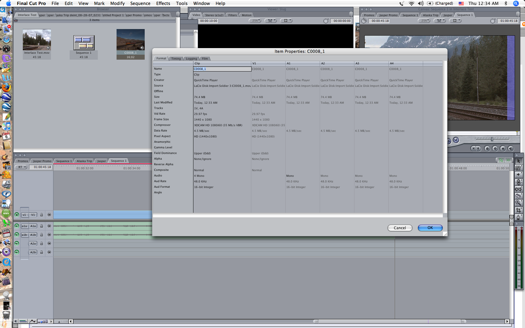

At last found the cause of the problem.
Was looking in the filters, and each and every clip has a filter enabled for "shift fields" +1.
The mystery is why this is, as I did not set a filter for this. Is there a global setting that I somehow enabled?
Anyway, take away the shift fields, and the train goes by normally!
