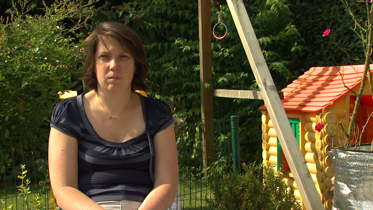

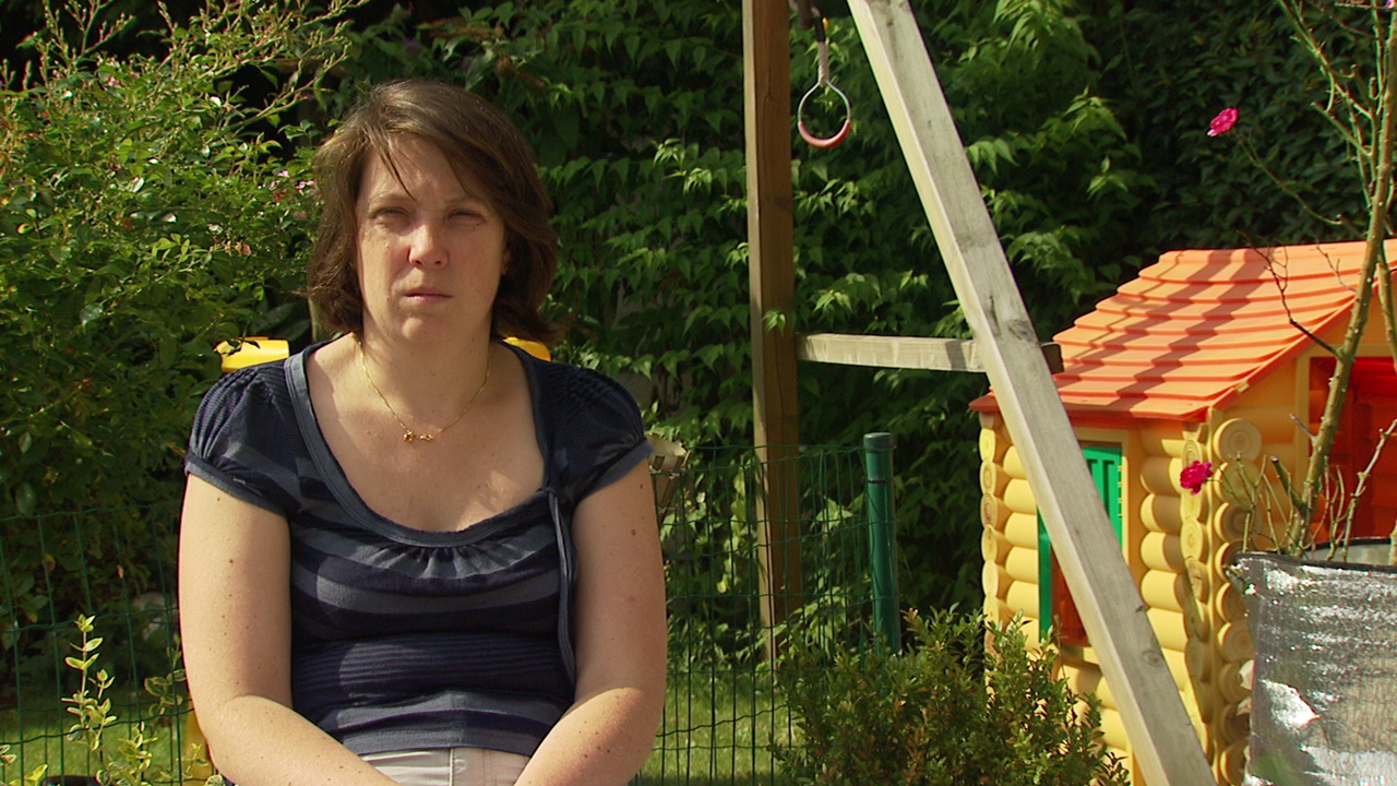

Alessandro,
which settings are you using from the posting you mention?
Like Alister said, try to use Cinegamma 4, it is much nicer on the highlights.
This morning I did some tests with Cinegamma 4 and the standard gamma. I've attached 2 pictures made with both settings. You can see the difference in how the highlights are handled nicer on the Cinegamma 4 setting (left picture). Look at the roof of the house in the background.
These are my settings for CineGamma 4:

shot in 1080 50i 35Mb HQ
Problem's with PDW-F350-cinetestsbuitencine4hue-3_1280x720.jpg   Problem's with PDW-F350-cinetestsbuitenfofic1280x720.jpg

Hi Richard, i use your settings for this shot.
Your's two sample image is very similar to my image but for me is too yellow :(
With cine gamma 4 is better on the highlight's
Alessandro Pinto is offline   Reply With Quote

Well, color is a very subjective thing.
You could start with Cine gamma 4, all the other paint settings at default and try a preset matrix. See if you like it. I would not try to setup the user matrix if you don't have the equipment to judge the picture correctly. My camera was initially setup by a professional engineer with all the techical intruments to judge the picture. This is now my reference scene file.
With the standard gamma I noticed some abrupt highlight clipping when you overexpose a bit, specially in peoples faces. with cine gamma 4 the highlights are more gradually clipped.
Richard
