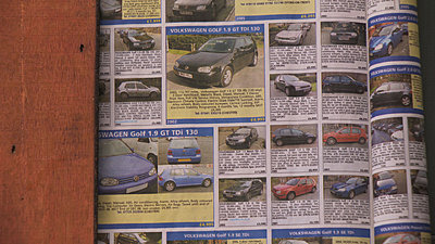

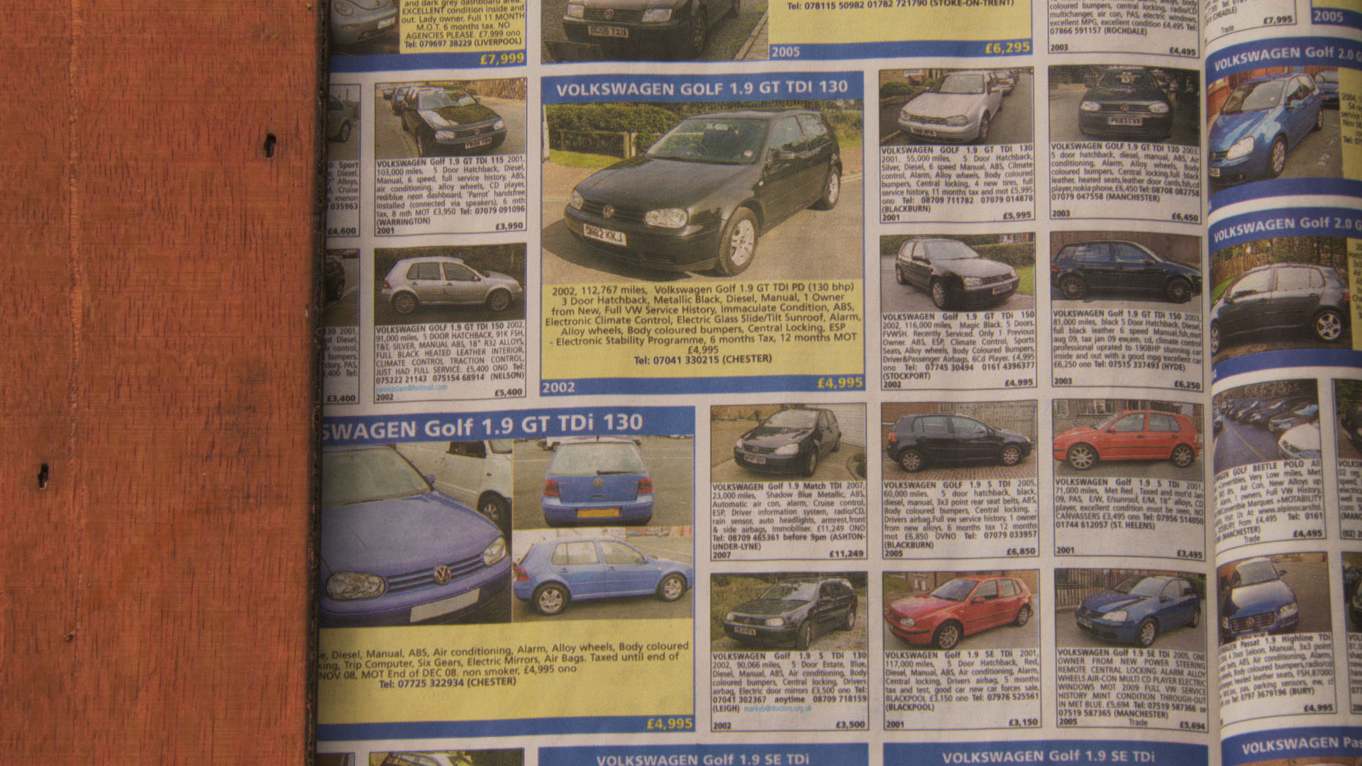

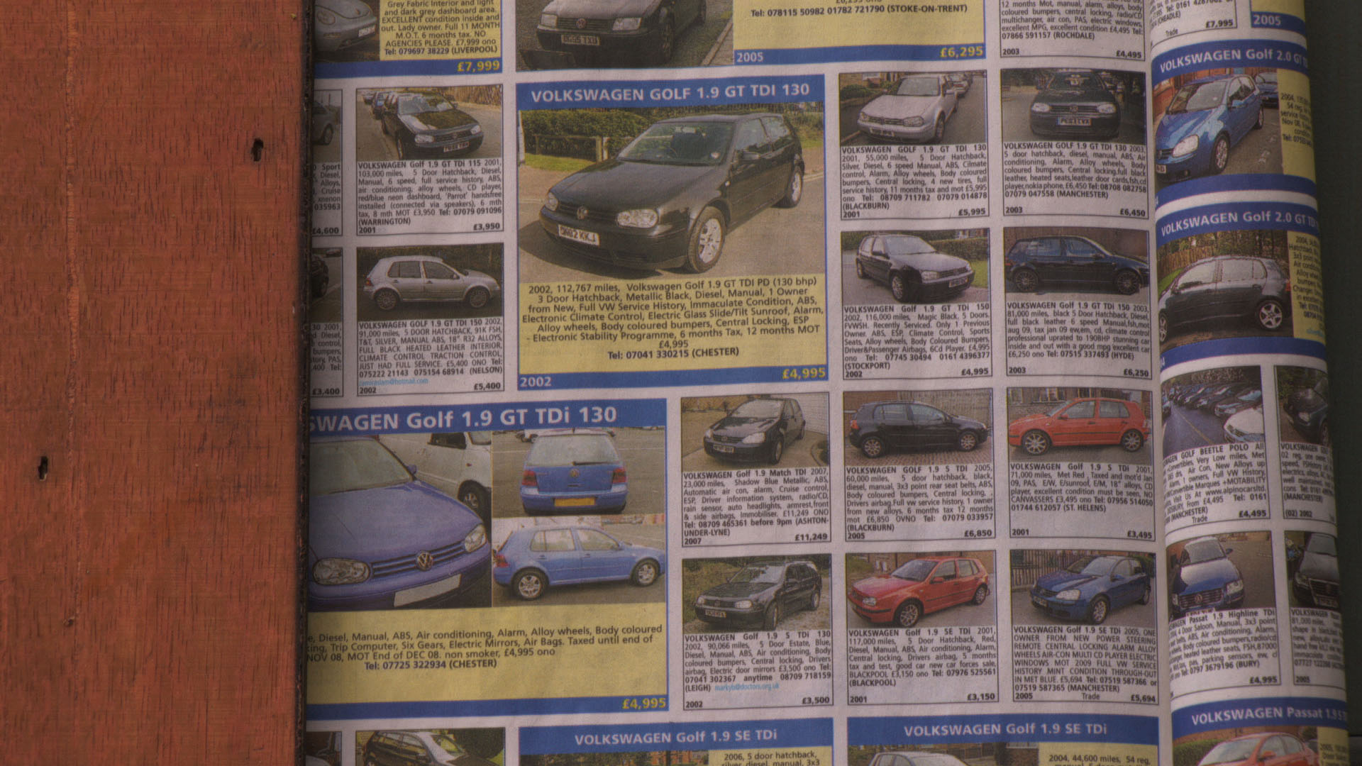

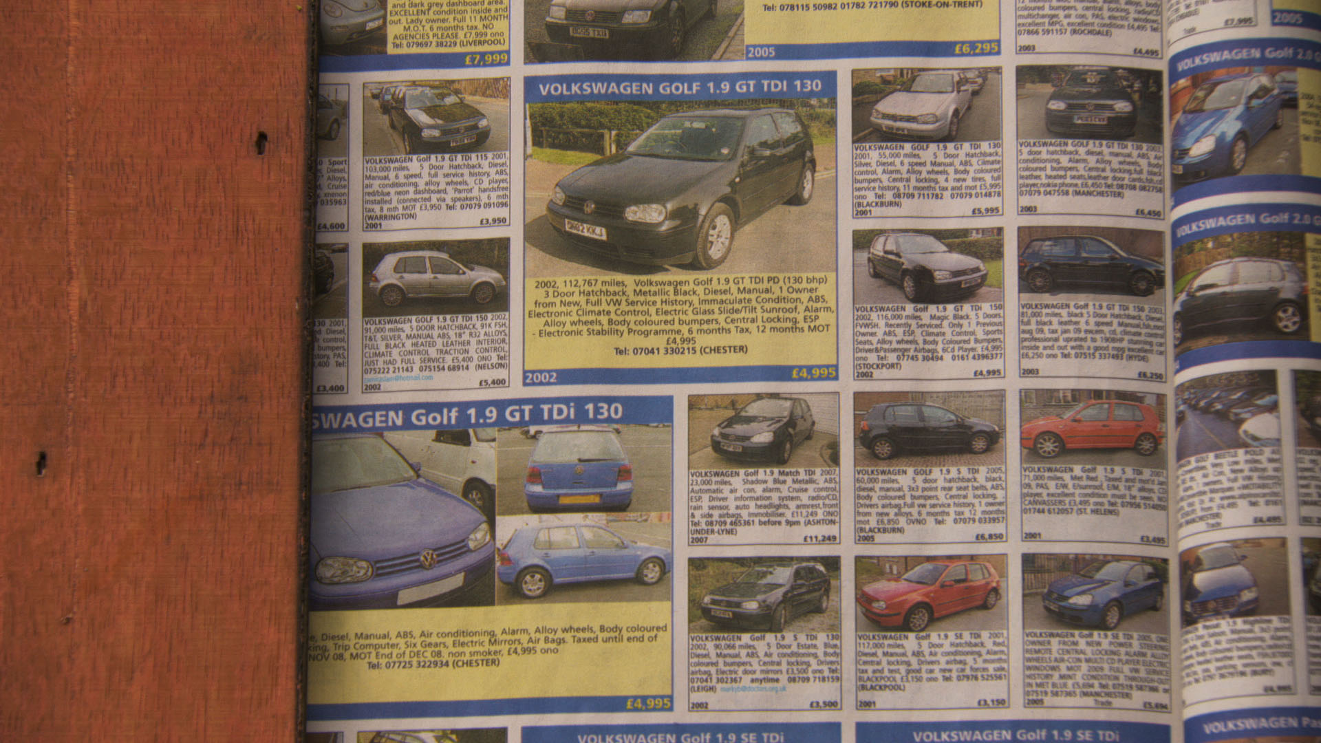

More HD Lens Tests
I've just shot a couple more lens comparisons, this time with news print (which seems to be a preferred method for some).
One of the lenses is a Fujinon HA22x7.8, the other a Canon J14x8.5, both at 40mm, shot first at f4 then at f8.
Thoughts, guesses?!
Steve

No idea which is which, but I'd say lens 1 looks sharper.
Old October 10th, 2008, 04:35 AM   #3
Location: NE of London, England
Posts: 788
I see little difference! Lens 1 may be slightly sharper.

Lens 1 is the SD lens. On the landscape shots I did there was a - fairly - noticeable difference but as you both say there's little to choose between them here.
Steve

From that test and the limitations of the monitor I am looking at these, there is certainly not a lot in it -
Lens 1 does look like it has the edge, but in a moving presentation there would be no perceivable difference.

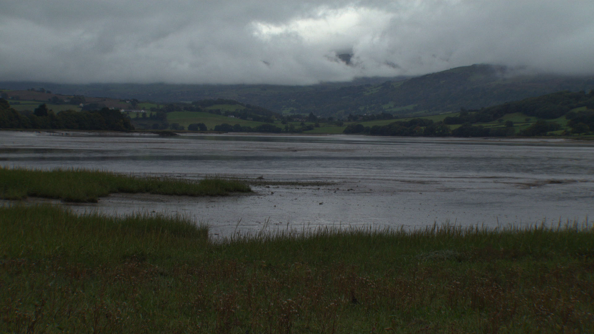

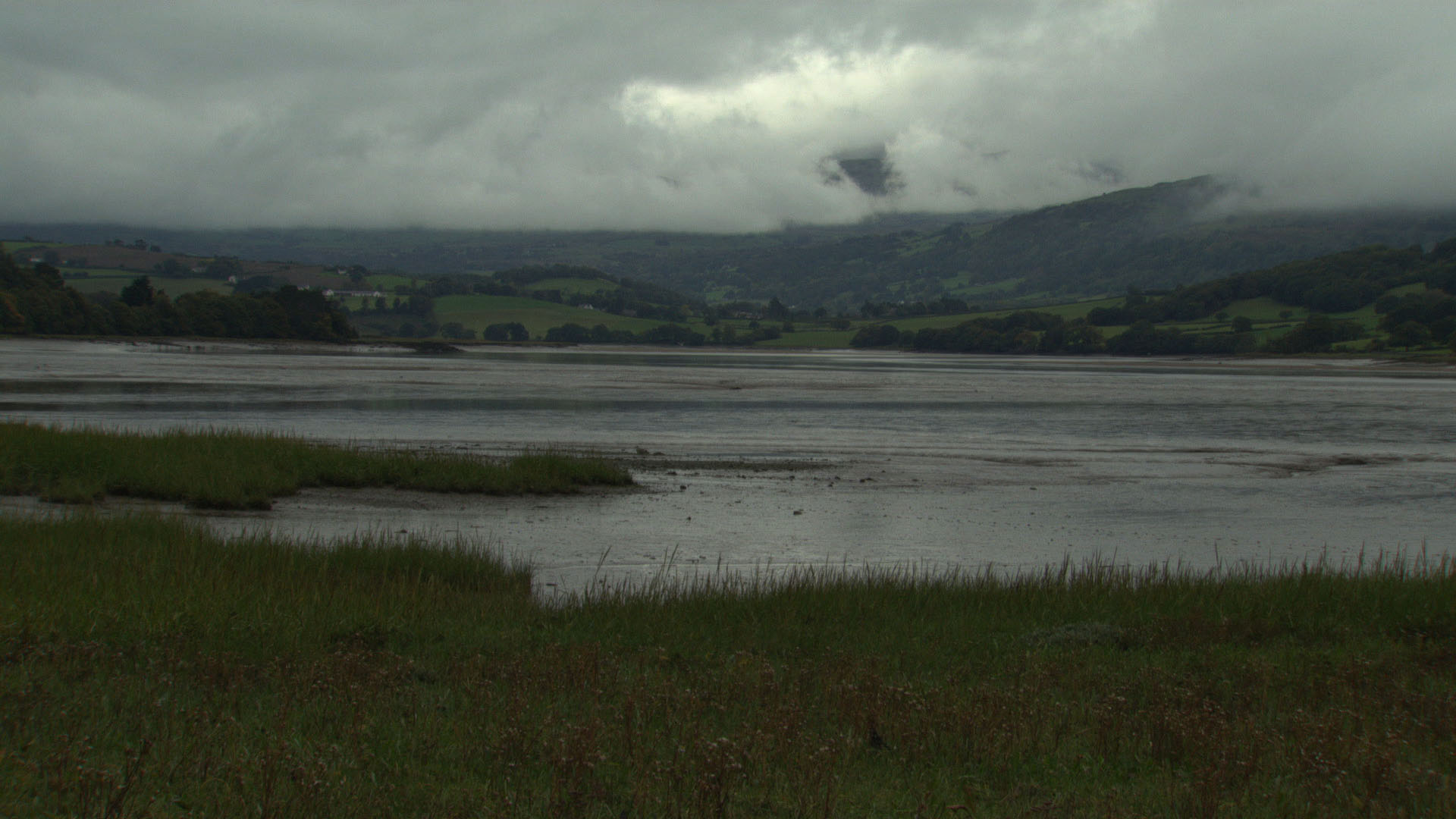

OK, here's a couple more. It's funny, but I can definitely see more of difference on the wide, landscape shots. It's still pretty damn close though.
Which is which this time?
Steve

I would guess lens #2 is the HD lens.
