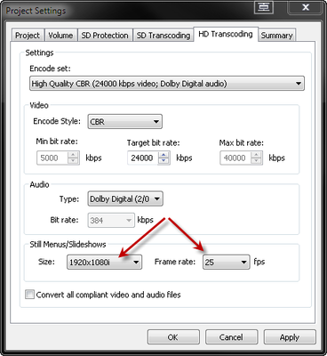

here is another thing that could cause your problem
the menu settings must match the movie settings
if the movie is progressive, the menu needs to be rendered progressive
if the menu is rendered interlaced and you push a button to start play, the video will stutter for a second or two while the changeover from interlace to progressive takes place
I use DVDit Pro HD for Blu-ray authoring and I can set my menu to match the movie, the frame rate must also match or you get the same stutter
http://www.videoproductions.com.au/e...-framerate.avi
or does your stutter happen while just watching the movie and a pan or zoom starts in the video, in that case I have no clue because I don't get these problems using interlaced
do you see these stutters when watching hollywood blu-ray releases that are progressive
also, are you watching on a true progressive display? Plasma? LCD?
is the display native 1920x1080?

Hi Anton,
Yep, that's the problem: the stutter happens only while watching the movie and a pan or zoom starts in the video - or an object starts moving fast. Only a second or so, then it goes on smoothly. That's what makes it so awkward.
It's on a full-HD LCD tv from Loewe, native 1920 x 1080 and true progressive.
Someone suggested it might be the bluray player that cannot keep up with the sudden peak in bitrate when an important (datawise) movement starts. I'm going to try and find another player to compare.
