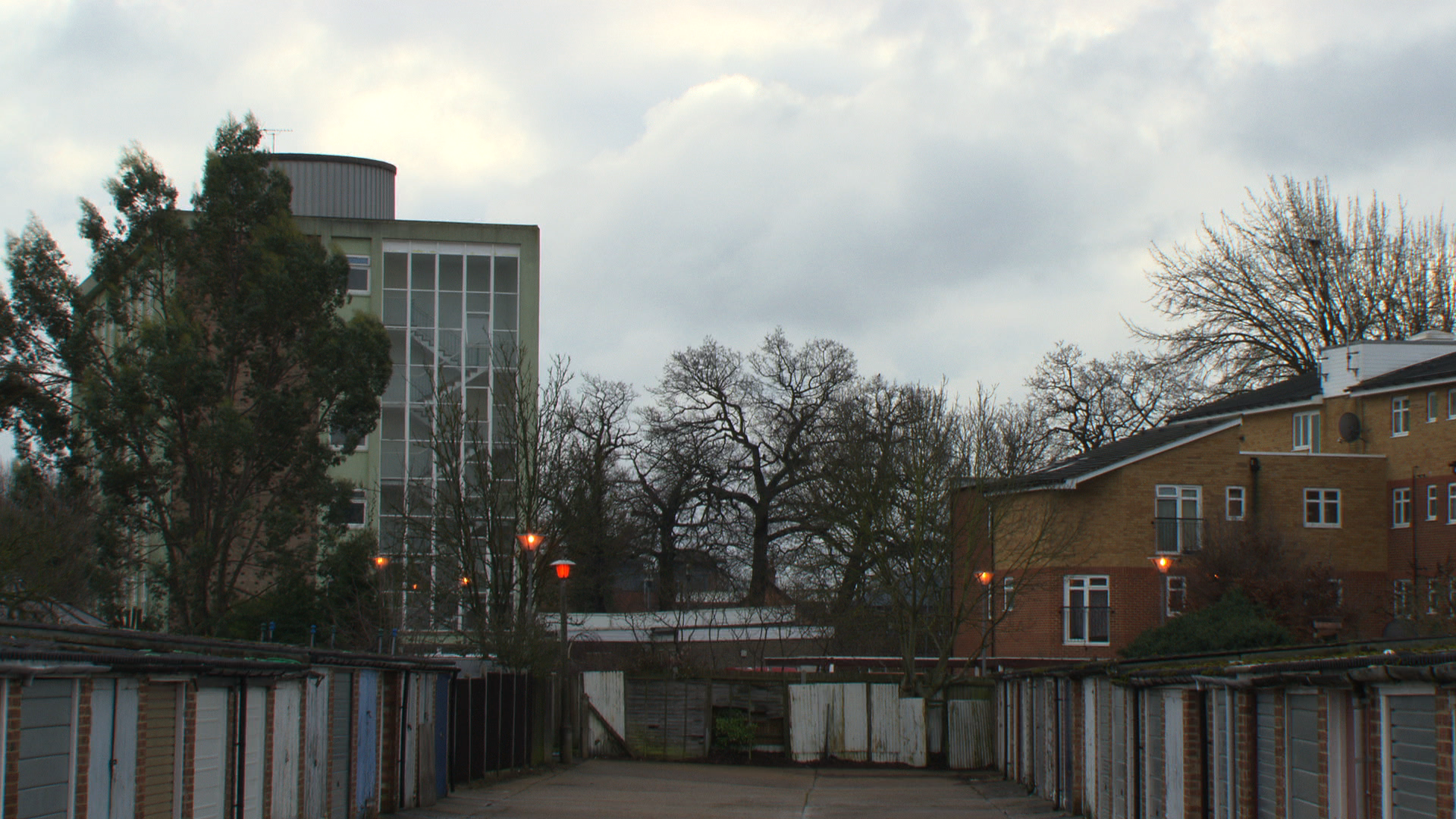

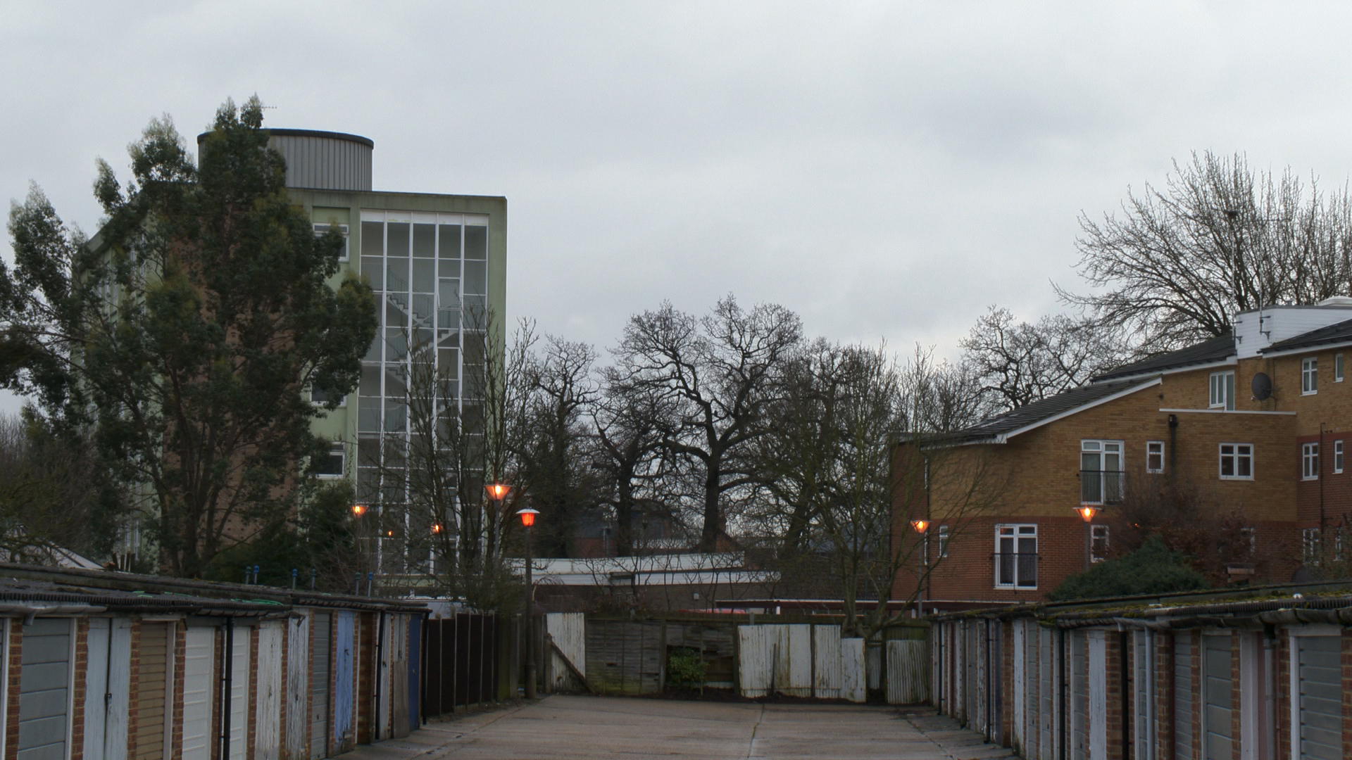

Here are a couple of frame grabs from my PDW-700 and PMW-350. These were done a little while ago, but shows how close these two cameras are (or can be).
Pdw-700, pdw-800, pmw-350-pdw-700-g1.bmp   Pdw-700, pdw-800, pmw-350-pmw-350-g1.bmp

Out of those two screen grabs, I prefer the 350. If that's the way your two cameras look, then I can understand the quandry you face in deciding which one to keep. Our experience has been very different.
What lenses? It appears to be the lens making the biggest difference, in favour of the 350.

The 700 had a Canon KJ20 and the 350 had it's kit lens. The KJ20 is not the best of HD lenses.
There are more reasons why the PDW-700/F800 and PMW-350 should look the same than there are reasons for them to be different. After all they both have 2/3" sensors of the same resolution with similar pixel size, very similar noise, sensitivity and dynamic range. That is then processed by 14 bit DSP's (so dynamic range should be the same) in both cameras, using the same gamma curves and color matrix and what should be the same detail levels (as we have discovered there are definitely differences here). CMOS and CCD sensors both use very similar MOS capacitor devices to capture the light, it is the read out methods that are different. With CMOS this used to mean more noise due to heat and the high frequency clock signals needed for readout and on chip analog to digital conversion. Sony have however now managed to tame this noise with on chip analog and digital noise sampling/reduction circuits so other than the read out method the difference in the signals produced by CCD and CMOS sensors should be minimal.
So other than motion, these cameras should look similar. Oh one more thing, the grabs were taken from the camera recordings, so the 350 is 4:2:0 35Mb/s and the 700 4:2:2, 50Mb/s. Both set to progressive, both cameras using the same gamma and matrix settings but different detail settings.

Alister I do like your 350.bmp over the 700.bmp for the buildings but not the sky. That is similar to what I have been seeing the latitude in the 350 seems limited compared to the 800 but better then the EX1/3.
