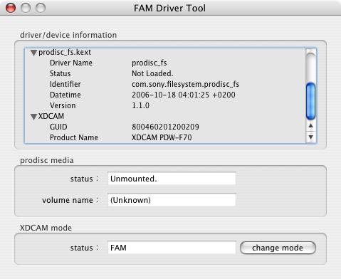

The PDW-F70 deck as well as the PDW-F350 were definetely in FAM mode. I even changed the mode from FAM mode to AV mode and back several times, using the FAM driver tool. And as I mentioned - if I connect the PDWs to our old G5 everything works fine. But I stumbeled on something: In the information window of the FAM driver tool on the intel Mac it states that the driver "prodisc_fs" is not loaded (see attached screenshot.). Th FAM driver tool on the G5 states that "prodisc_fs" is loaded. So that seems to be the problem. I tried to install the transfer tool again, hoping the driver might be correctly installed on the second try. No luck. Maybe I should completely uninstall the package but I don't know were all the drivers are located. Any ideas how I could get ALL the XDCam transfer stuff off my system so I can do a clean reinstall of the software?

How to Manually Remove FAM Driver components from OSX
Christian,
It seems the owner/permissions are incorrectly set on your FAM drivers during install. Try install again after doing the steps below to remove the FAM drivers.
How to manually remove the Sony FAM Driver software from the computer.
Okay. Break out the terminal. Take a deep breath and type the following in:
Code:
sudo rm -rf /System/Library/Filesystems/prodisc.fs
sudo rm -rf /System/Library/Extensions/FAMProtocol.kext
sudo rm -rf /System/Library/Extensions/prodisc_fs.kext
sudo rm -rf /sbin/mount_prodiscfs
** You will be prompted to enter your password upon first command.
** Warning! I take no responsibility for any damage done to your OS when doing this. Yadda Yadda Yadda...
After doing this, re-install the XDCam 1.1 software. If you still aren't successful, run the Disk Utility and Repair Permissions on your disc. The utility will read the installed package receipts and reset the permissions for the installed itsems so the OS doesn't freak out.
Plan B:
Alternately, you may MANUALLY change permissions of the FAM driver installed components so that the MacOS will load them by doing the following:
Open the terminal. Take a deep breath and type the following in:
Code:
sudo chmod 755 /System/Library/Filesystems/prodisc.fs
sudo chmod 755 /System/Library/Extensions/FAMProtocol.kext
sudo chmod 755 /System/Library/Extensions/prodisc_fs.kext
sudo chmod 755 /sbin/mount_prodiscfs
Then...
Code:
sudo chown root:wheel /System/Library/Filesystems/prodisc.fs
sudo chown root:wheel /System/Library/Extensions/FAMProtocol.kext
sudo chown root:wheel /System/Library/Extensions/prodisc_fs.kext
sudo chown root:wheel /sbin/mount_prodiscfs
Then restart your mac.
** now that the permissions/owner/group is set right, the Mac should load these at startup...
best regards,
-Greg
