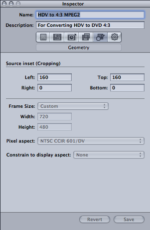

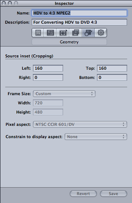

You don't have to specify a different frame size in Compressor to get the side crop.
Just go with 720x480 as always, and tell it to crop 160 from right and left.
