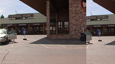

Not sure exactly how to describe this problem, so I'm attaching an image too. . .

When I export at 1920x1080 (square pixels), my new files have an odd, flickering repetition of a part of the left side of the frame in the right third of the frame (see attached picture).
This problem is codec-independent: I get the same results exporting to Quicktime, .WMV, H.264, or Lagarith .AVI.
This problem does NOT happen if I export to a different size or pixel aspect ratio.
This problem does NOT happen with footage captured from tape through Premiere Pro (.Mpeg extension).
This problem does NOT happen if I "Interpret Footage" in Premiere Pro and select "Conform to Square Pixels (1.0)" and then scale my footage horizontally by 133.3% in the Effect Controls after placing the clip on the timeline.
The problem-area seems to me, to be occupying the difference in space that would be taken by 1440x1080 footage with square pixels and 1920x1080 footage with square pixels.
