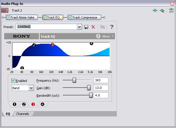

There have been a couple of threads on the low output level of the supplied shotgun mic (being low indeed - nobody questioned that), as well as the overall quality of the V1's audio section (disputable - some said it's extremely poor with the rolloff frequency being as high as some 1200 Hz, others strongly denying).
Well, I guess I can shed some more light on this, with a first-hand experience I've just had. Some of you may remember my posts on how well the live music performance in a church came out for me recently, using the Edirol CS-50 stereo mic:
http://www.dvinfo.net/conf/showpost....31&postcount=1
In fact, I was pleasantly surprised with the sound quality - until, that is, I received the sound track recorded independently by a radio station crew. Well, the two tracks' main differences are:
- the camera recording is much louder (which denies accusations on the whole audio section, not just the mic, being too low)
- the radio recording is by far reacher in lower frequencies (which confirms the claims of the V1 not being very good at producing flat freq response).
I was able to equalize the V1 audio track in Vegas to sound almost identical to the radio professional recording, so it's not that bad, after all. However, it can only work provided the audio is free from any handling noises, hums etc - otherwise, gaining up lower bands by more than 10 dB over quite a considerable bandwidth would inevitably bring the noises up, rendering the footage useless; the bottom line being that the V1 lacks in lower freq response for sure.
Just take a look at how much I had to equalize!

Of course the microphone is an important link in the chain, but I have a lot of references on the internet that this model (Edirol CS-50) is renowned for being capable of 50Hz-20kHz +/-3dB, so it isn't likely to be the weakest link in this regard.
I'd like to stress though that the overall sound quality is good enough to get equalized very easily, and after bass boosting is no worse than the professional audio recording I'm comparing it to. I wonder, how do other camera of this class compare?

Yeah, that's exactly what I stated in the original post. But then again, if there really is an unusually high bass roll-off that weakens the bass content of music being recorded, for instance - it'll also weaken the handling noise, won't it...Who knows, perhaps this is the purpose of the roll-off? Cause otherwise, I can't imagine why couldn't the V1 offer a flat freq response, when even the chaepest audio recording devices can?

Yes, the two radio mics were placed 2 meters away from where my tripod was located. But let me express my reservations for one more time: I've no idea if and how the radio recording was processed before I got it on a CD; it's quite possible it was also equalized in one way or another! One thing is certain: the frist time I heard it, I knew it was better in the bass department than my own. However, this is by no means any proof that the V1 has indeed a roll-off at 1200 Hz by -14dB!
Whatever the specifics of what may be happening in the V1U's audio system, you did say in your first post that "the radio recording is by far reacher in lower frequencies (which confirms the claims of the V1 not being very good at producing flat freq response)."
Would you be willing to try the test I suggested to try to discover exactly what the V1U's audio frequency response is?

it's already been done. More than once. Using both test tone generators and noise.
The FUD post that is here on DVInfo.net contains some of that discussion and result.
Christopher, if you're reading and accepting of that information, then the only test result that will likely satisfy you is one you take yourself.
The V1u, given a flat tone, at a standard level, will reproduce that tone. Given the variables of a microphone, room tone, and whatever other variables may be introduced isn't a test, it's a guess.
Putting in an oscillator sweep produces fairly accurate reproduction up to about 16k and down to approx 80Hz. This is typical of compressed formats.

Sorry I didn't respond earlier. No, sorry - I have no testing facility or time for it; it's my eyes and ears I always trust. The picture from my V1E is gorgous, and the audio can be equalized to sound exactly like a pro recording. In fact, this has been the point of my posting: be aware that - should you expect to get some hi-fi music on tape - you're gonna have to play with it in post. The good thing is it can be done, and I'm happy with it. BTW, should I trust those many who say the V1 audio is also too low, I'd probably have turned the gain manually all the way up, not leaving enough room for equalization. I didn't (it was manual, but merely at 6-7) - and the recording is very loud, no distorsion, clipping etc. And possible to equalize, so what's the big deal?
With regards to your suggestion on any low-frequency inherent noise: no, there isn't any. Mind you, the music I recorded was quiet, chamber music (just violin and guitar), and yet - after boosting the basses up with as much as 14 dB - no hum or anything similar is audible. Yes, there was a very low frequency noise in my audio (the mic was on the working camera, and the DR60 drive was attached to it, too), only audible when using a high-end home theater system with LFE on and a subwoofer; you can see on my graph I cut it away as well (below some 40 Hz). If the V1 audio was that prohibitive on basses as claimed by the FUD posts mentioned above, nothing of this kind would ever get to tape!
