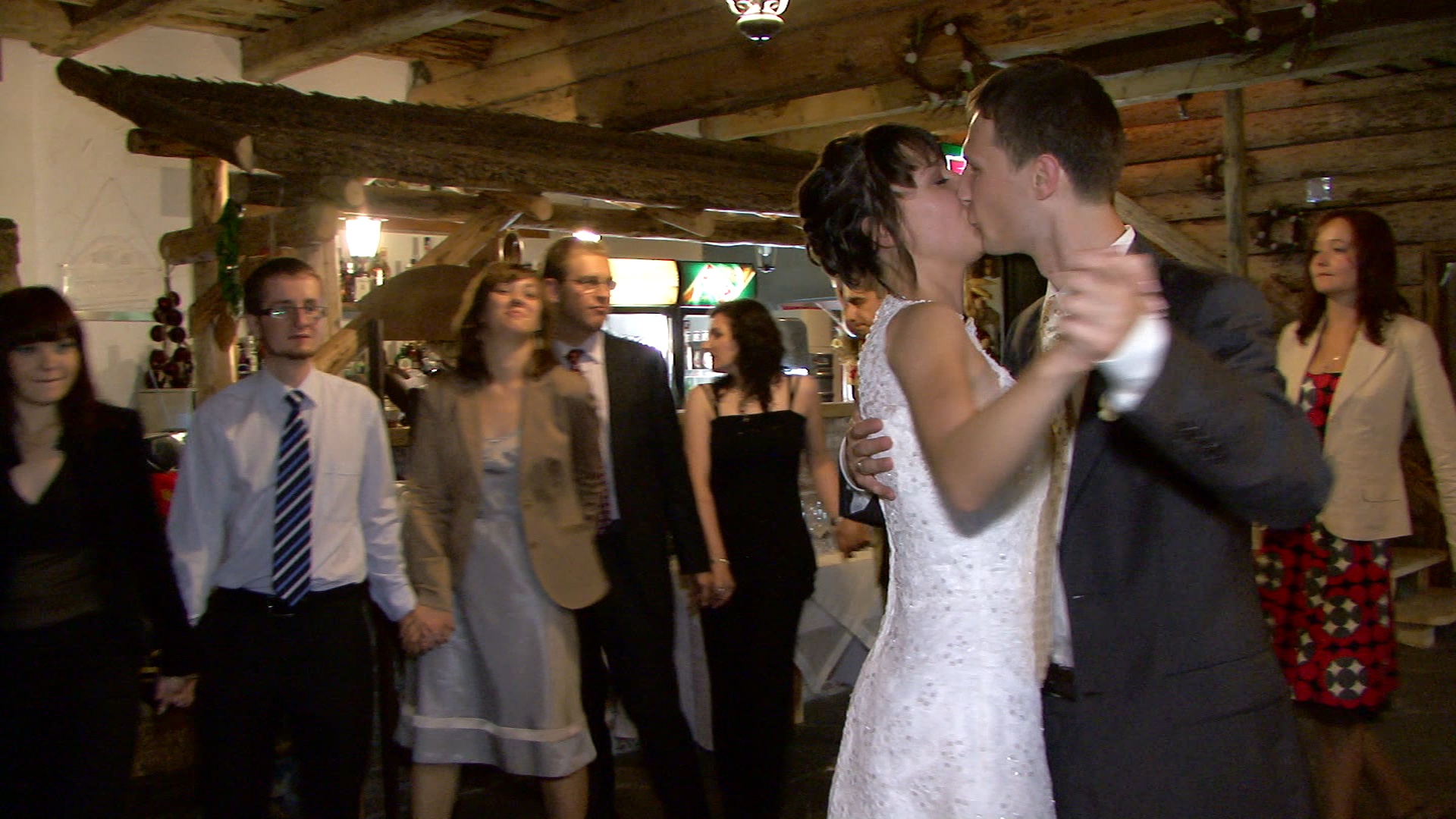

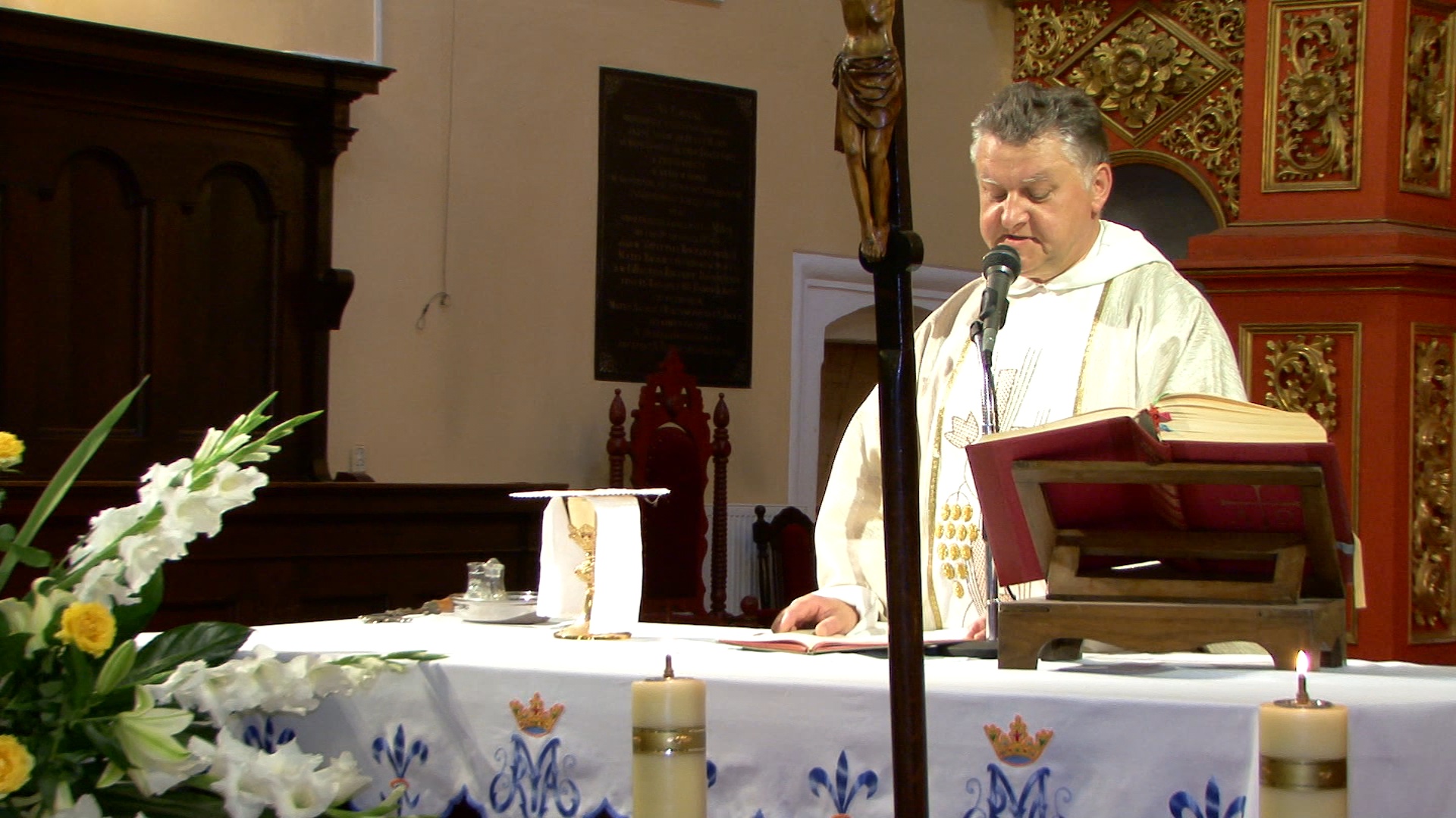

Looking at the grab attached, can anyone say this is a poorly performing camera? Typical wedding ceremony, in-church lighting (yes I used the HVL-LBP on-camera light, but the distance in this particular shot was over 10m)!
EDIT John, here you are!
Old October 27th, 2007, 05:49 AM   #15
Location: Pinellas Park
Posts: 232
I don't think anyone is claiming that this is a poorly performing camera. It just has its shortcomings in low light. The scene that you snapshot has a decent amount of light. Show me a scene of a dimly lit dance floor at a reception. That would be a good test of low light performance.
