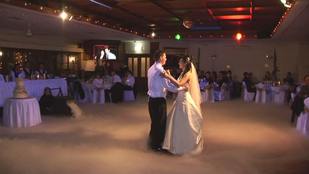

I might enter this debate here as I've been running a FX 7 since December and last week bought a FX 1 as a second camera.
Yes, I had two VX 2000's for five years and I mostly do dance concerts and weddings.
This week I feel like a weight has been lifted off my shoulders!
Last night I put last week's wedding into the computer, my first with the FX 1, and the reception footage reminded me of my Vx 2000's....without the heavy grain.
Using Sony's HVl LBP light, the CCD camera had a much lighter depth of field and was much more natural/pleasant to look at, than footage at the same venue with my FX 7 (yes I've used it at 25fps PAL too) which gets quite soft AND hunts focus when in low light. (let alonne the problems with photgraphers flashes that I have posted before).
Heavier camera, completely unbalanced with the heavy light on the front, but one happy camper here!
Cheers Vaughan

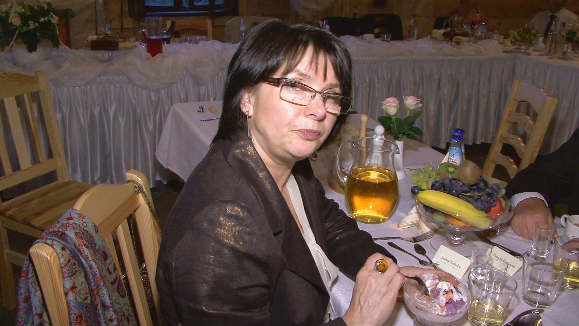

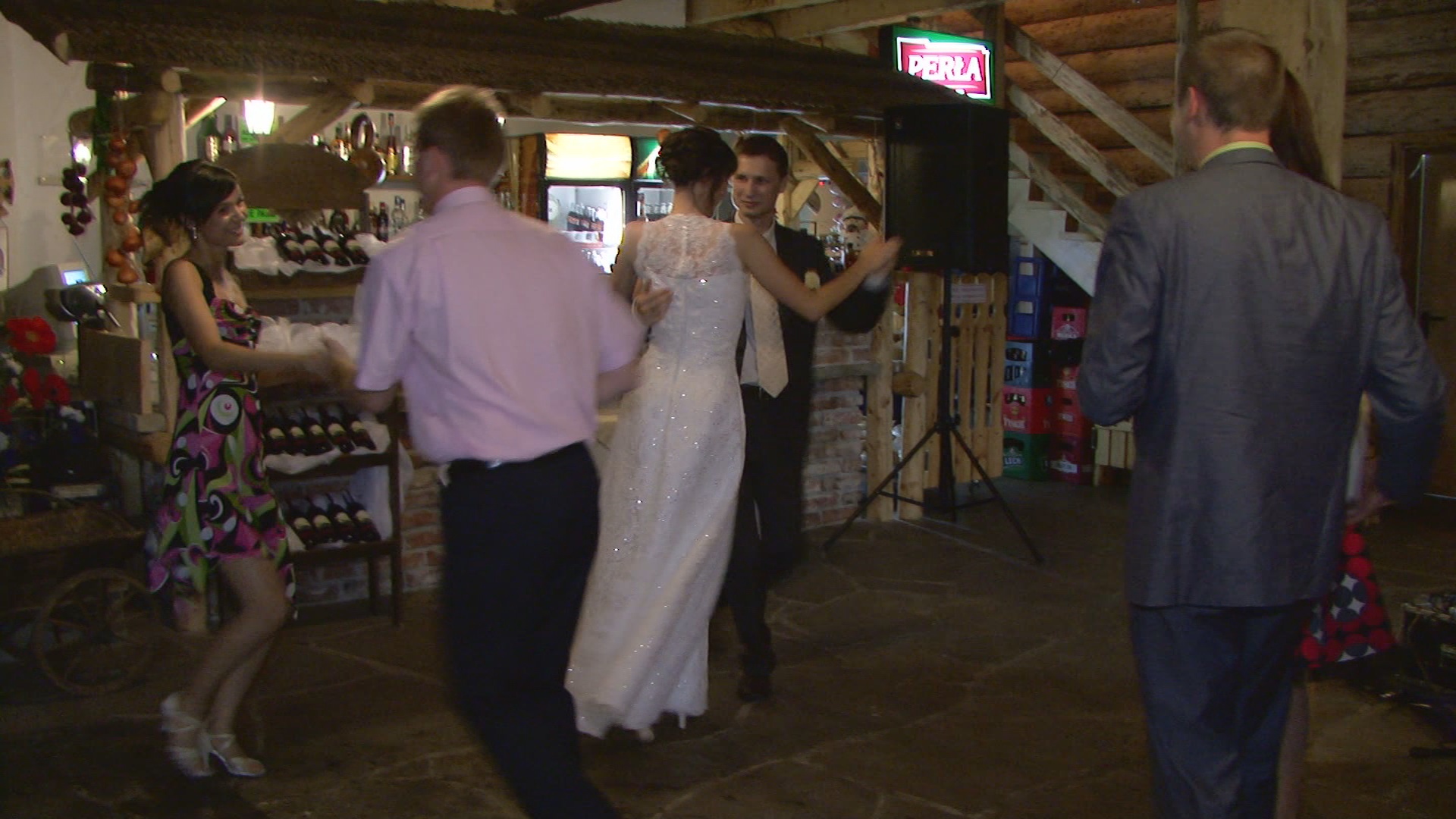

Originally Posted by Vaughan Wood View Post
IUsing Sony's HVl LBP light, the CCD camera had a much lighter depth of field and was much more natural/pleasant to look at, than footage at the same venue with my FX 7 (yes I've used it at 25fps PAL too) which gets quite soft AND hunts focus when in low light. (let alonne the problems with photgraphers flashes that I have posted before).
I guess you misunderstood Markus' remark on the full extra stop with 1/25th still giving full framerate; it only applies to the V1 in progressive mode! In 1080/50i you only have on the FX7, 1/25th will brighten the image, but also introduce smear which is not acceptable save for artistic purposes.
With the V1E, I'm always using 1/25th with 25p in dark venues and never have to exceed 6-9dB of gain, which keeps me way on the safe side regarding noise. The left grab was taken in a very dark place indeed, and with lots of movement in a fast dance - yet the smearing looks only natural!
How are the noise levels on this camera?-image28.jpg   How are the noise levels on this camera?-image29.jpg
