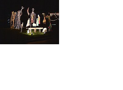

Here is night shot out of the truck window using these night setting, I wanted to try them, still got some noise when darker.
Hugh Mobley is offline   Reply With Quote

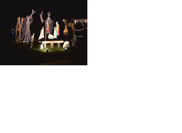

Thanks for all the help guys. After playing with the settings I think I've finally cracked it.
http://img241.imageshack.us/my.php?i...ehvrv1eye2.jpg
Terry Terrell is offline   Reply
