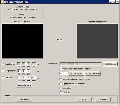

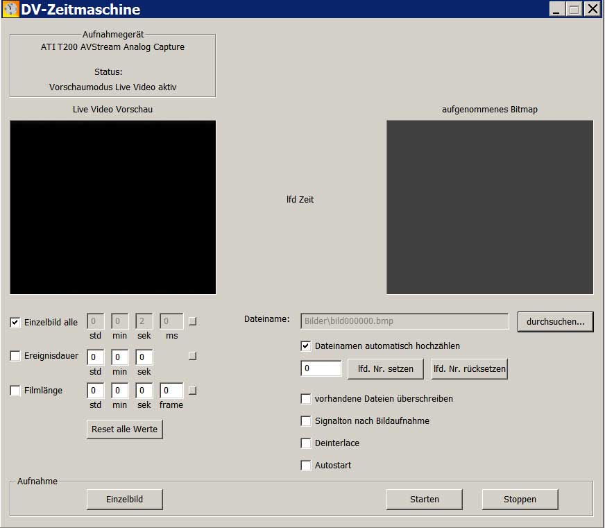

No video camera I know can shoot single frames, like the old movie cameras.
With my former DVCAM-Camera Sony PD 150 I used a little program to capture real single frames. If the camera was on, but not recording, you could see the live picture on the display.
Trough firewire you could transfer the image in real-time to a computer/laptop
The program would now save one frame (bmp) after an odder to your hard-disk, as long as you like and at defined intervals. All you had to do, was the keep the camera and the laptop running
Today, with HDV cameras, the program can’t be used, as it is not further developed
From the V1E you can, through the HDMI out, export the live video uncompressed directly to a fast Raid on a computer, if you use the Blackmagic Intensity-card.
If you had a HDMI PCMCIA adapter to a fast laptop, you could save single frames, if the ZM-program would allow capturing 16:9 HD(V) frames
Dos someone know of another program like ZM and is there a HDMI-PCMCIA-adapter around?
