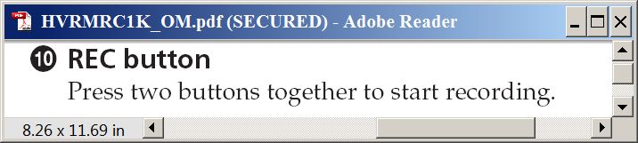

Old April 28th, 2011, 04:57 PM   #9
Location: Woodinville, WA USA
Posts: 3,467
Re: Sony FX7 External Recording
It's on Page 4:
