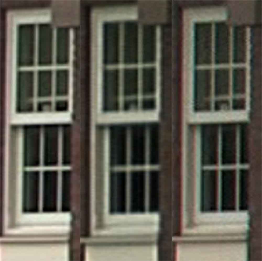

One related question: on the Sony site, the comparison picture shows big black lines around the edges of window panes, white cornerstones, etc for the V1 that are not there in the other images and undoubtly not there in real life. What caused that? Only the Canon picked up detail in the window lock mechanism.

It looks like its just way over-sharpened. I never really understood the usefullness of that comparison chart. Its provided by Sony, so it might have the appearance of being biased. We have no clue whatsoever what the camera settings are (that alone nullifies the comparison). And frankly, when I first saw that graphic I wasn't even sure why Sony bothered; to me it looks like the HVX is resolving a pretty decent amount of detail (after being poo pooed by many for being so "low resolution") and the Canon shot looks the best to a lot of people anyway.
You know, just looking at that "comparison" is a reminder of how similarly all these cameras perform. What's the point of endlessly shooting still life and then zooming into frame grabs to see how the 700 line camcorder supposedly looks better than the 540 line camcorder. Ugh.. I think if there's another HD camcorder "shootout" I'm going to petition that no resolution charts are used. Lets look at colors, lattitude, smear, ergonomics, price.. etc.. anything other than resolution. OK, I'm going on a tirade.. better get back to work.

For the numbers I gave I used a 75% factor horizontally and vertically on the bayer CFA, which is about right with a good demosaic and decent optical low pass filter. For the Sony, looking at how it works, they seem to trade extra horizontal for vertical, and it seemed that, given how such things work, a 150% horizontal and a 75% vertical factor would be appropriate. AS I say, it's a guesstimate.
Yes, the lines are just over-zealous sharpening. Yes, the difference between the three is small, with to my eyes, the Canon looking superior and to have the least amount of sharpening too. It still has too much, but, less is better than more.

You only posted one of the images on the Sony site. There is a 3 picture series of images on the Sony site. I prefer either of the other 2 images (Sony or Panasonic) over the Canon image. The numbers don't tell it all. The proof is in the pudding. What I see is much red fringing on the vertical edges of the window in the Canon image. The Sony image in this same series appears to me to be superior. It's just as clear to my eye and does not have the red fringing problems of the Canon image. How can you overlook the red fringing and talk about resolution?
There is more going on here, and it isn't the numbers. I think this is why Sony used this image. It appears to point out problems with the lens or the processor in the Canon camera.

Or problems in the test itself. I'd hardly call it a controlled test, and we only get to see a small section of the image that was shot. You can't evaluate a camera from a single image.

Actually, I photoshop'd the windows together an enlarged it. There was a definite purple fringe in the Canon. And a much higher level of detail. Enlarged, the Sony had pronouced edge enhancement (I assume thats what those black streaks are) and loss of surface texture (which may be an overactive noise reduction). To me, the Canon had the edge in resolving vertical lines, and the Sony had a edge on horizontal lines. However, what do I know?

Come on, this is advertising 101.
Any company will make their product look better when compared to the competition. Is Tide really that much better then "product B", or are the ads on TV set up to make the other laundry soap not work as well?
Well over a dozen things could have been adjusted alone on any of those cameras to adjust how the image looks. The images could have also been adjusted later in photoshop.
I'm not calling SONY anything but this is just how marketing and advertising work. I would do the same thing as would anybody else on the planet if they were marketing a product that competed against another product.
My point is to not take the image from the SONY site for any decent information to judge the cameras. Either check them out yourself or wait until somebody such as Adam Wilt can compare the results and put the cameras through a fair test.

No Photoshopping was done on any of those images whatsoever. I'd hate to think that Canon or Panasonic would Photoshop an image for their best interests either. Then again...some companies have done camera marketing DVDs that didn't use the camera they're marketing for the shot.

Beware, conspiracy theorists! None of these manufacturers would ever photoshop a comparison image. They'll simulate an LCD display image on a brochure, but they won't touch a comparison shot.
