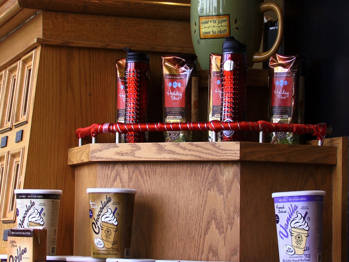

Here are three images. Is one of significantly lower quality? Which one?
If you can't see a difference, then 30P has no problem in my prototype V1U.
Images of 30P, 24p, and 60i-image-1.jpg   Images of 30P, 24p, and 60i-image-2.jpg

I like pic # 1 the best!
Pic #3 seems a bit soft.

Steve,
From left to right, #2 looks the sharpest, followed by #1 then #3, with #3 being the softest.

#1 looks clean while I can notice some of the oil paint look in images #2 and #3. In the wood grain image 1 looks more natural while 2 and 3 take on kind of a cartoon look. Actually when I look very close I think all 3 images have this it is just it is at different levels.
On 2 and 3 do any of us think wood grain looks like that? 1 looks a lot more natural to me but there is still something "funny" about it. Look at the far left of all three images at the area around the grey squares. That does not look natural. I have worked with 35mm footage and all types of HDV footage for compositing and I can tell you that these images look funky. How would keying work on something like this when the edges get enhanced? We would have dancing edges.
One last thing I will point out is the chroma sampling in all 3 images. Notice the alternating lines of chroma due to the fact that even progressive is encoded as an interlaced stream. This will also make keying a little bit harder if you are going to a progressive source such as BD, HD-DVD or film. Your NLE will have to know how to compensate for the alternating lines of chroma. Clearly whatever program Steve used to take these stills couldn't yet tell the difference so it thinks they are all interlaced and the chroma looks like that. You really notice it in the reds. If you plan on creating a 1080p HD disk of some type the chroma will need to be sorted in the correct order.

The wood grain in the third image seems quite blurry/smudgy...
The second image looks to be perhaps overly sharpened.
But nice clean blacks. Colors seem very nice.
I've forgotton the details of your worry about field encoded MPEG, but all 1080i ATSC has this issue -- and yet I've yet to see any huge protest about this as being a big quality issue. There are many other interlace problems, and this one is just one more. It seems to me that you are simply pointing-out one of the many advantages of progressive.
In the case of Sony 24p, 25p, and 30p -- I don't see that these modes will look any worse than 50i or 60i. And, that really is the only important point to someone buying a V1.
It seems irrelevant to point-out that 720p offers better chroma. It also offers 60p. But, if folks want 720p they obviously aren't going to buy any Sony camcorder. So I'm not sure why you keep pointing this issue on the V1 thread.

Hi Steve, certainly these shots look much better than any of the V1E shots and none of them show the "oil painting" effect. The 3rd photo is visibly softer than the others -- I wonder which setting has been used.
I've posted a new Image 3.

Going by the similarities between 202 & 203, I'd say the progressive pics do suffer a little bit of the smudging in the V1U. Not as bad as the 25P pics shown by others. The wood grain does look funky as Thomas points out. Were these pics sharpened at all?
