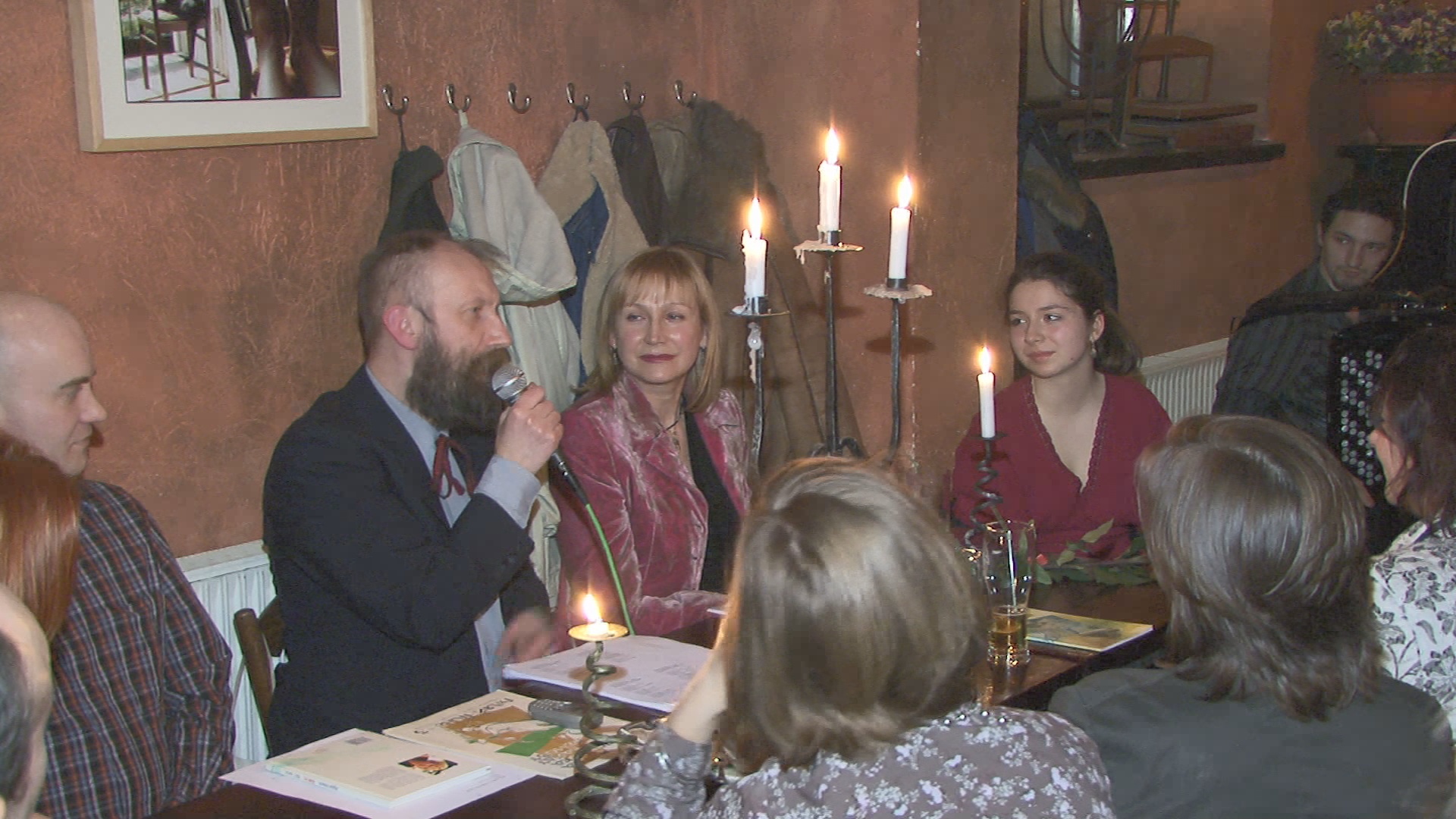

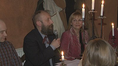

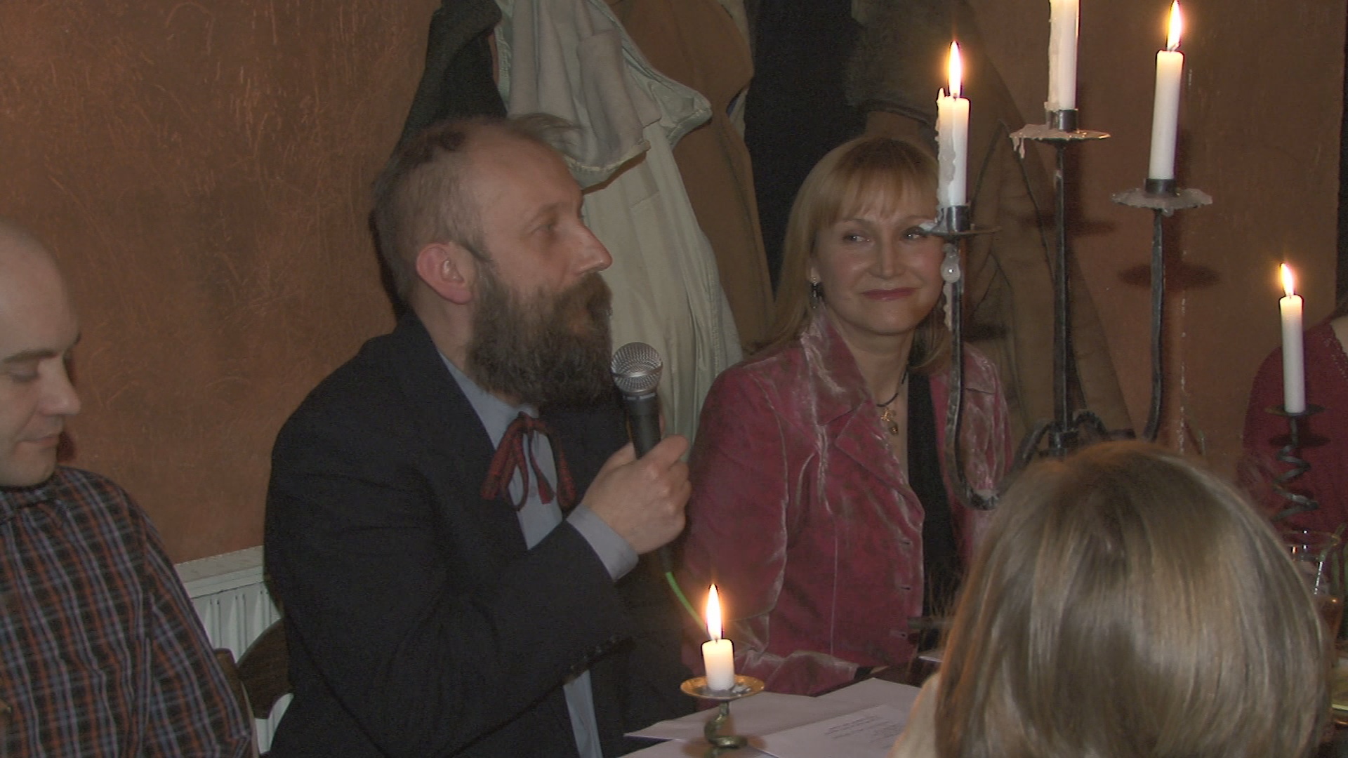

I had blacks stretched to get most of the dim surroundings. In spite of this, the dark areas simply remained dark, but noice is almost unnoticeable - like in this snapshot:
V1 in low light: first true event impressions-eyp-evening1.jpg   V1 in low light: first true event impressions-eyp-evening5.jpg
Was the only lighting source those candles? If so, the image is truly amazing. You have to love the way the V1 handles bright lights; the flames have a nice rounded soft look rather than the harsh star-like verticle smear of CCD type camcorders. Very nice... Thanks for the pic.
There's no way the candles are the only light source. Look at the shadows (or lack of).
You're right Drew; I have uploaded another snapshot into my previous post above where you can see a lamp at the ceiling. There were a couple of lamps like this scattered around the room, but all very dim indeed.

Posts: 1,961
It really looks like you have some on-camera light. There are shadows cast from the candelabra straight behind them and a few inches low. There is a similar shadow cast from the face of the man in the denim jacket. This means there must be a light in line with and above the camera pointing at the scene. Also, the shadows moved from the first shot to the second meaning that the light must have moved. The fact that the background isn't underlit usually means that the light near the camera isn't very strong, but it really looks like you have an on-camera light. Perhaps the overhead light just happened to line up with your camera?

Markus, this is funny:) Yes I can see the shadows you're talking about, but you're investigating as if I said there were just 10 candles there and nothing else. Of course there were lamps like the one on the second snapshot I added (not much brighter than the candles), and yes - there was a bar some distance behind me, where people were having drinks and listening.
But it is obvious that the place was generally dark, and when I was entering, my first thought was I couldn't probably make a watcheable video there. And yet, it's a nice surprise!

Location: Honolulu, HI
Posts: 1,961
Yes, I can tell that it's dark as the candles look so bright. Candles don't seem so bright in a well-lit room and are barely visible in the sun. Regardless, I can't shake the feeling that it seems like there is an on-camera light. It's not the overall brightness, but the pattern of the light. Maybe one of the room lights just happened to line up to look like an on-camera light.
Maybe you brightened the image too much. That's hard to believe, but maybe the overall even lighting dampens the feel that it's in a dim room? I know the V1 isn't bad in low-light once it is tweaked properly, so I don't doubt this kind of shot is possible in the right person's hands.

Posts: 4,086
Markus, I just scrolled through the timeline and found the moment when somebody was taking a still with a mobile phone from behind me; you can see the same scene with his flash (of course neither me nor the camera was fast enough to compensate for this additional light). But, it is not that much brighter at all, which means you're right saying I managed to lighten the scene as much as possible, using pretty low shutter speed and stretching blacks.

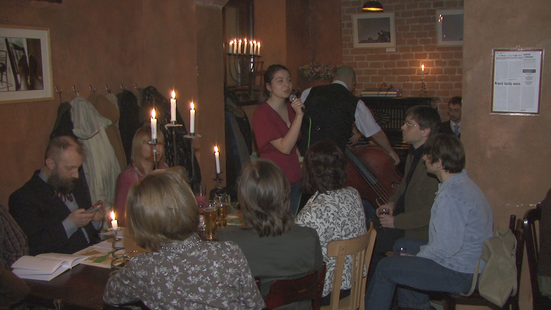

In EYP Evening5.jpg there's something very odd happening with that double bass.
Old March 26th, 2007, 09:29 AM   #15
Location: Poland
Posts: 4,086
Let me guess: the oil paint effect!
