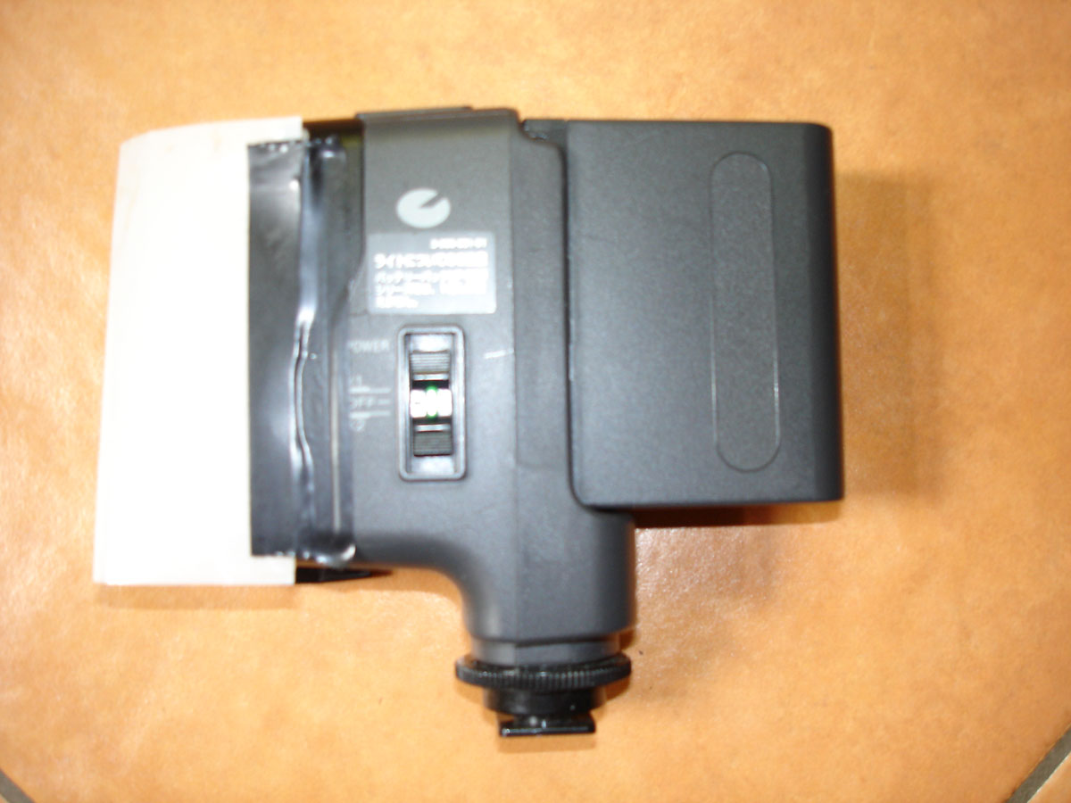

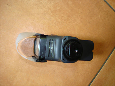

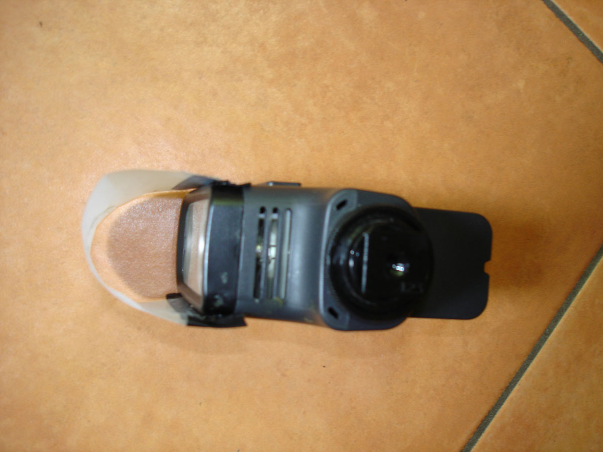

Tim, if you have any diffusion paper around, try this.
Cut a rectangle the same height as the light. You will tape each edge (electrical tape works great) alongside the light so that the paper curves out in front of the bulbs.
This is a great and nearly free way of adding diffusion to this light to make it less harsh, and lets you use both bulbs when you need to for extra reach.
Mine's looking a bit beat up cause I yanked it off to put it on a new light, but with care it looks nice and neat.
