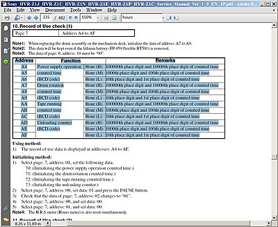

I had this done for my FX1s before I sold them. You need to go into a service center that has a diagnostic remote and they can read out all the hours for you. You need a chart to interpret the hex values but it has all the same info as the Z1.

That's what I assumed. I have a diagnostic remote which I bought to be able to check my TRV900, (amongst other things). Years ago, John Beal posted the memory locations on his very useful TRV900 website. See here:
rm95
I wondered if anybody here knew the respective memory locations for the data on the FX1.

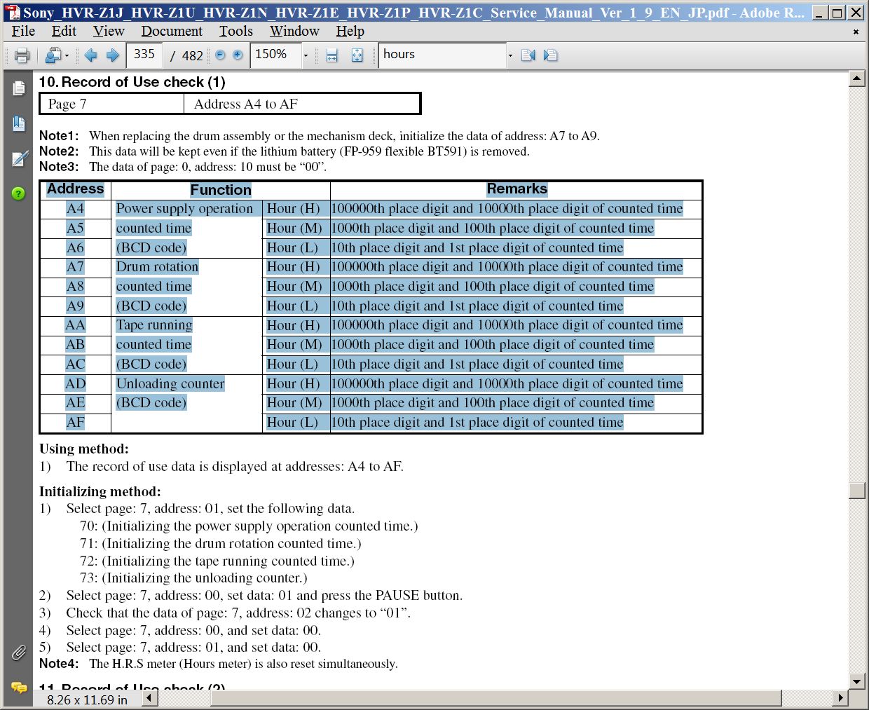

I remember we had to look in a service manual of some sort. The FX1 service manual I have makes no mention of this, so it must be somewhere else. Wish I could help more.
Ah! Found it, in the Z1 service manual:

I checked the figures in the memory locations that you gave me from the Z1 manual and I get:
257 hours powered up
141 hours drum rotation
97 hours tape running
355 unload counts
I then unloaded and reloaded the tape and the last figure rose by 1. I've been trying to find this out since I bought the camera in 2005. Thanks very much for the info.
