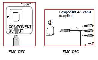

I've been able to pick up the component cables from time to time on eBay. But be careful -- they have changed the connector at the camera end, so the one that fits the FX1/Z1 is not the same as the newer version that fits the Z5 and the like. The older ones had the rectangular ones with two of the corners nipped off diagonally, while the newer ones are rounded. Confusingly, they are both called the D-connector. The only way to be sure is using the model number of the cable -- the one you want is called the VMC-30VC. It is not interchangeable with the newer VMC-30FC.

The component cable is the 'D' type shown (VMC30VC) but the audio output (along with composite video) is through a 4-pole jack. The other 'D' type cable was used on lated cameras. A cable like this is needed:

But yes, the manual does note that the audio is output through the AV jack, so you need that cable as well. I guess that's why the Composite version is linked. You need both. There is a shorter version of the 30VC called the 15VC.
Component: https://www.amazon.com/Replacement-V...PD9CTY43JMH870
or
https://www.amazon.com/Sony-VMC-30VC...&keywords=30vc
