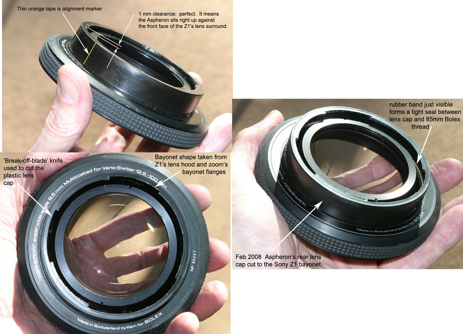

Did I show you my Aspheron bayonet for the Z1? Cut out of the hard plastic lens cap using a scalpel and a bit-at-a-time. Works exceedingly well.

That looks good Tom. I might have done it that way if I'd thought of it at the time but my modified Z1 hood is still working well and gives a bit of protection/shade too.

It has an 85 mm attachment thread and you'll need to get an 85 mm to 72 mm special adapter made. Have a look at my quickie engineering drawing shown in post #5, or better yet cut the rear lens cap into the Z1 bayonet.

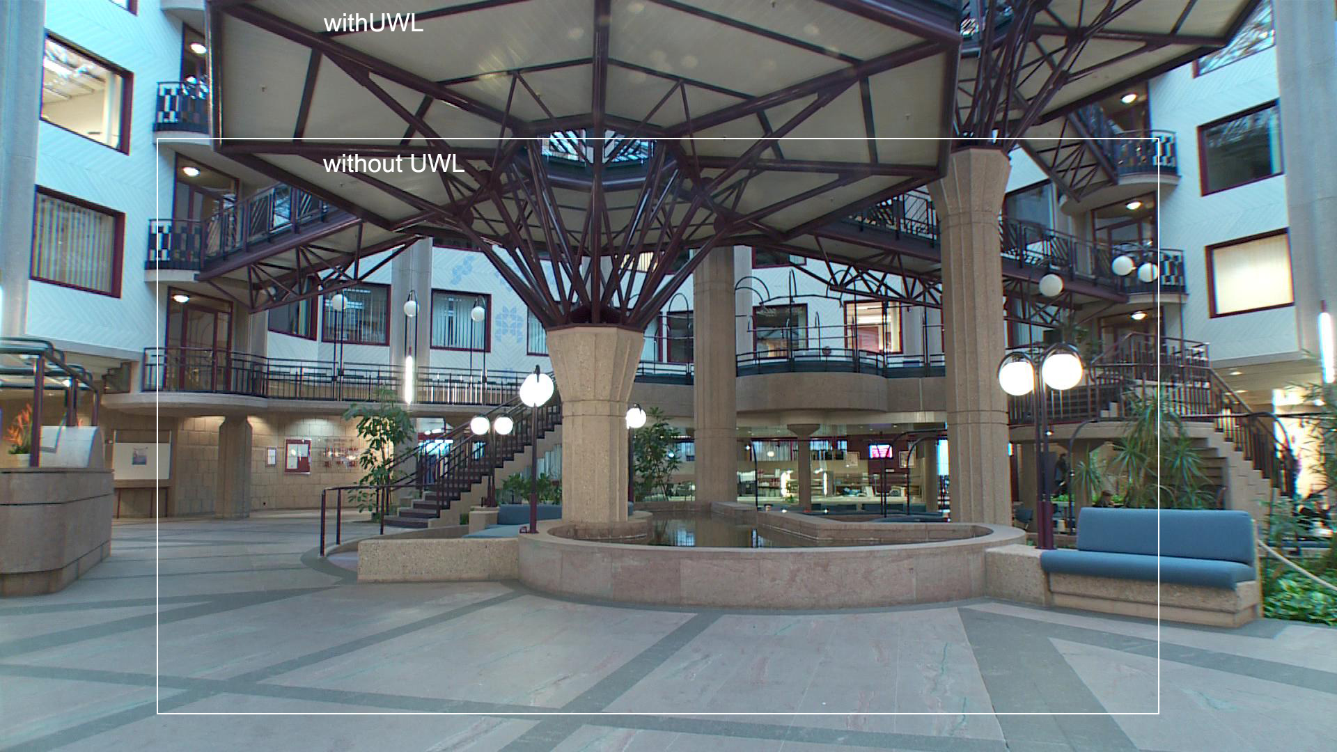

We speak already about some other low cost adapter. I tested mine (the UWL IV) on the EX1 (since by chance the filter size is 77mm) and results are very good.
This adapter is still affordable (under 500$).
Frame grab with the EX1 with and without the adapter.
http://www.giroud.com/divers/avec.bmp
http://www.giroud.com/divers/sans.bmp

Can we have jpegs Giroud? The bitmaps are taking a week to load this end.

Yes, no problem, it was just to avoid any problem cause by jpeg compression.
http://www.giroud.com/divers/avec.jpg
http://www.giroud.com/divers/sans.jpg

I've superimposed on on 'tother Giroud, and it shows the dramatic increase in field of view obtainable by using the UWL on the EX1. I'm pleased to see that the slight barrel distortion shown by the EX1's lens is all but eliminated by fitting the UWL, which makes the fov of the combo something like 17 mm in 35 mm still camera terms.
Your UWL is uncoated though, isn't it? Have you managed to hood the element at all? I'm so pleased to see this works, as my (beautifully T* coated) Aspheron has too small an outside diameter to work on the EX1.
