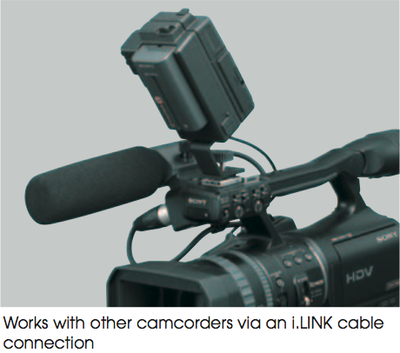

There's an adapter plate & shoe mount.

Yes, the cold shoe adapter that comes with the unit secures it to the Fx1000. Thanks Ken!

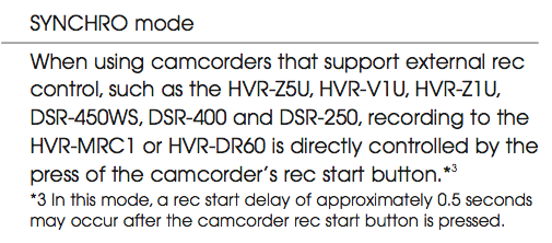

Yes, the recorder will record simultaneously.
"The HVR-MRC1K captures the HDV™, DVCAM™, or DV stream output from the camcorder and allows users to record HDV/DVCAM/DV files to a standard CompactFlash® solid-state memory card, while simultaneously recording to tape."

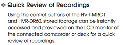

And Yes, the data can be previewed.

My understanding is that it will work via Firewire with the 1000 camera BUT WILL NOT automatically sync up with the rec/pause button on the camera.
This means you would have to manually press record on the CF unit meaning you could easily forget to pop it back in record.

I think you've nailed it Martin. The FX1000 and MRC1 will record simultaneously with the tape but not in sync. So, yes, the buttons have to be pushed separately and they don't have the automatic SYNC capabilites that the Z5 and MRC1 does.

Looks like the fact that it won't auto sync record with the FX-1000 makes the selection of the Z5U a no brainer...
