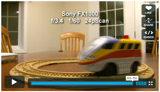

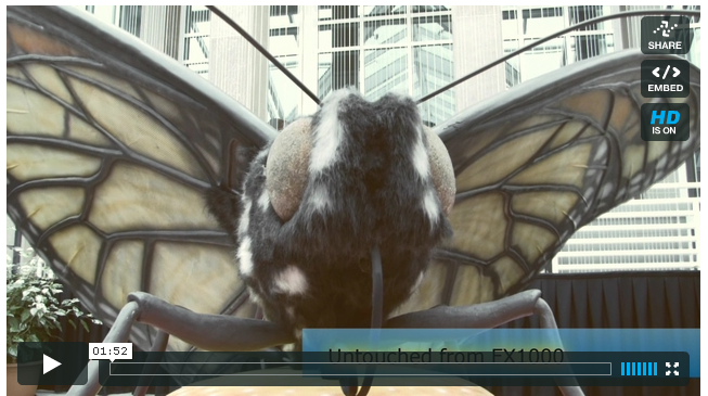

What render template did you use? Vimeo usually has a little HD icon on the right if it's HD. Below is a screenshot of your Vimeo clip and one that I've uploaded.
And, I'm not really understanding your comment/recommendation. I shoot 24p and render it out to YouTubeHD or Vimeo selecting the proper project properties (in Vegas) and appropriate render settings. Vegas does it all. I don't do anything specific or *special* to remove pulldown. As I've said countless times now, the combination of the FX1000 and Vegas Pro 8.0c makes 24p delivery effortless.
Btw Cesar, the biggest reason for shooting 24p is to get the film cadence. You have to couple that with a 1/48 shutter, not 1/60 that's shown on your Vimeo clip.

It is totally possible that you would shoot 24fps at a higher shutter than 1/24 or 1/48. I wanted to use a shutter of 1/60 so that all modes and cameras could use the same shutter. You would still have 24 frames per second, but each frame was exposed for 1/60 second.
Dragging the shutter will only cause more motion blur regardless of the camera.
You will note that *if* Vegas removed pulldown from the 24pScan (FX1000) clip, it would look the same as the 24F (XHA1) clip. It does not. Shooting 60i on the FX1000 and then letting Vegas render a 24p clip, actually generates an image that is much closer. Pause the image during the 24pScan clip and you can see that the crisp clean images are there just "doubled."
I'm sure that running the 24pScan through Cineform's converter would get me a clip that looks like the 24F stuff. Right now I don't want to think about adding more processing to the workflow. If I'm going to do that, I might as well get an HMC-150 and say good-bye to tape and drop outs.
Everything was placed on an HDV 24p timeline, set up just the way DSE specifies.
I rendered using this template
http://eugenia.gnomefiles.org/images/mainconcept.png
The only difference is that since the test is a 24p deliverable, I set the framerate to 24.
Regarding other differences between the XH-A1 and the FX-1000. The FX1000 puts out a sharper, less noisy image (both were at 12db gain), and has better ergonomics. When delivering 24p, the Canon puts out a crisper image of objects in motion. Dragging the shutter to 1/48 on the Canon would have likely made an image closer to the FX-1000's 60i->24p.

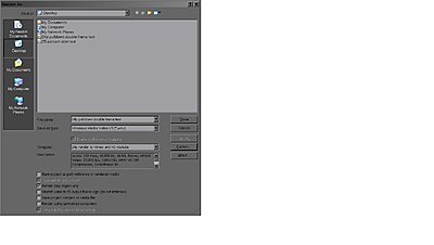

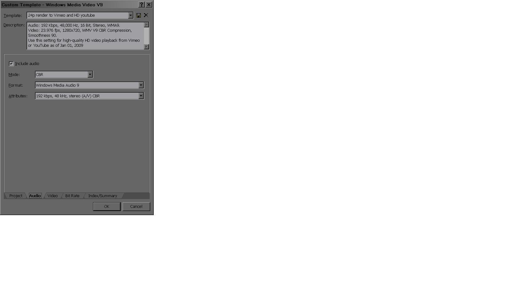

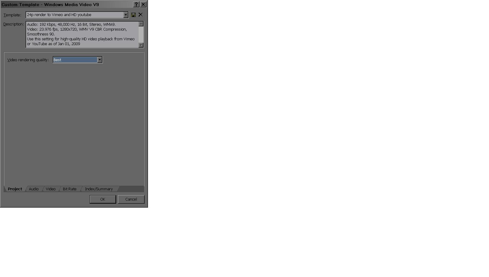

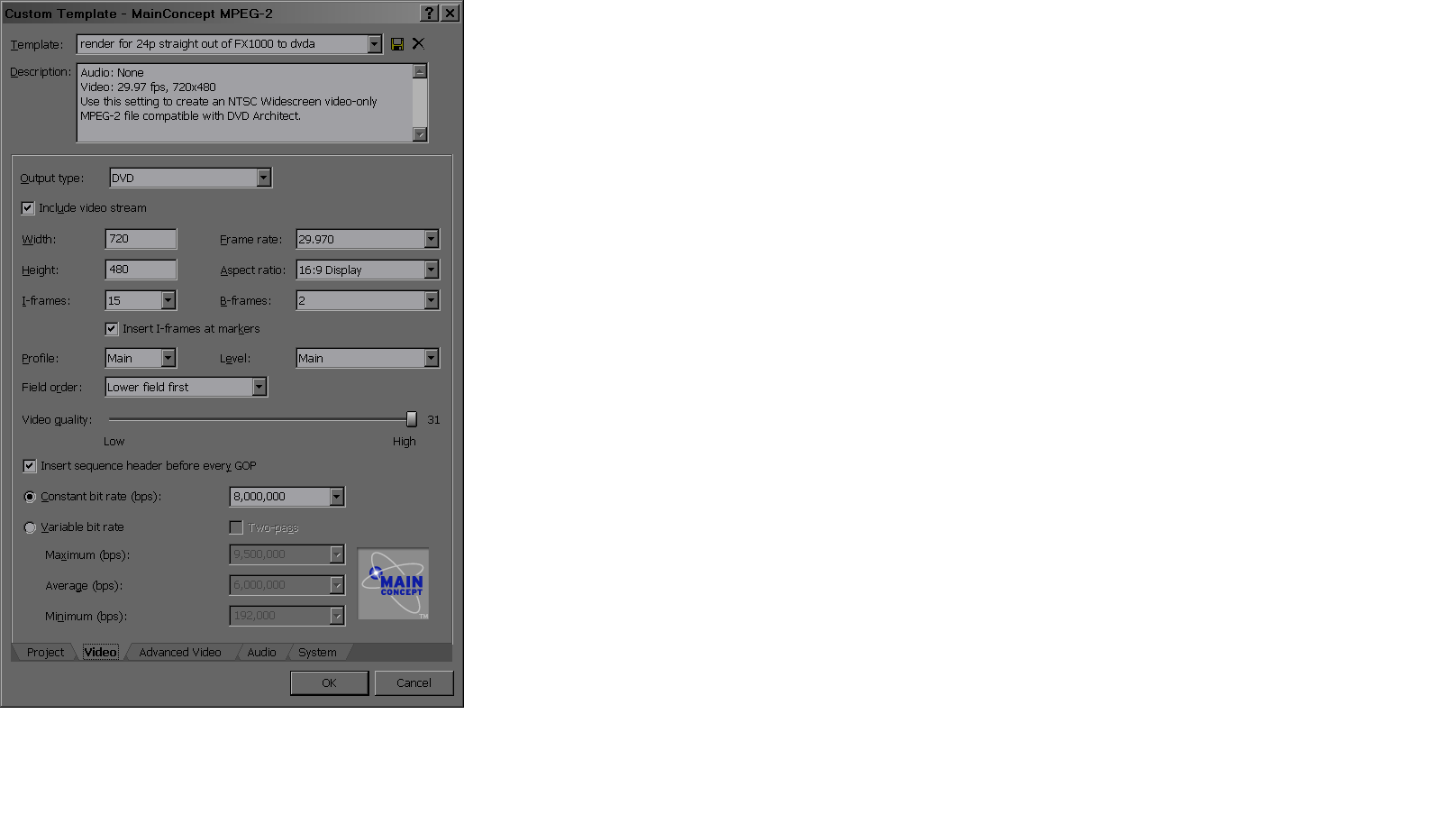

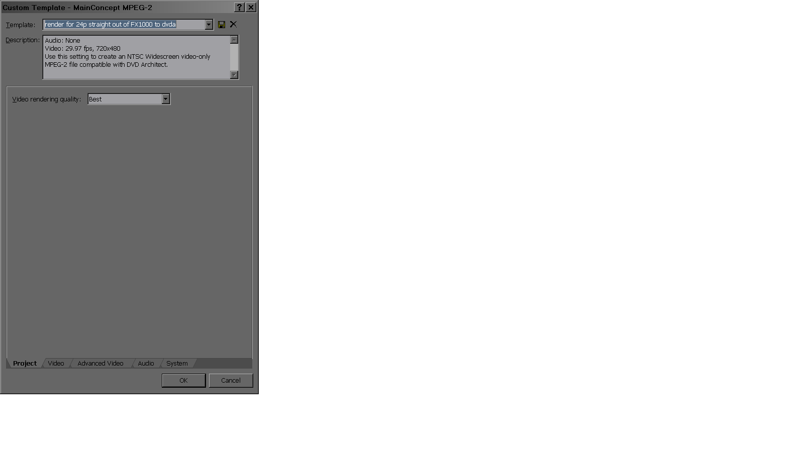

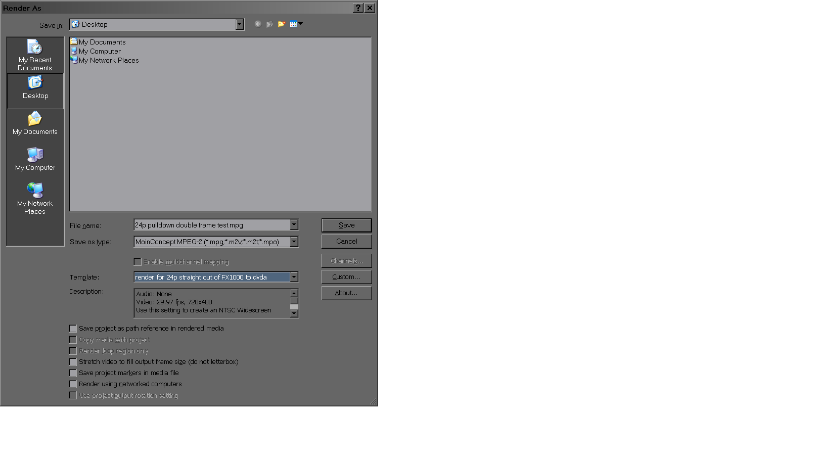

Now you have me counting frames Cesar. There seems to be *doubles* in my 24p timeline but when I render to the settings pictured below, there are NO DOUBLE FRAMES. I forget which template I modified but it's all there for you to duplicate if you wish.

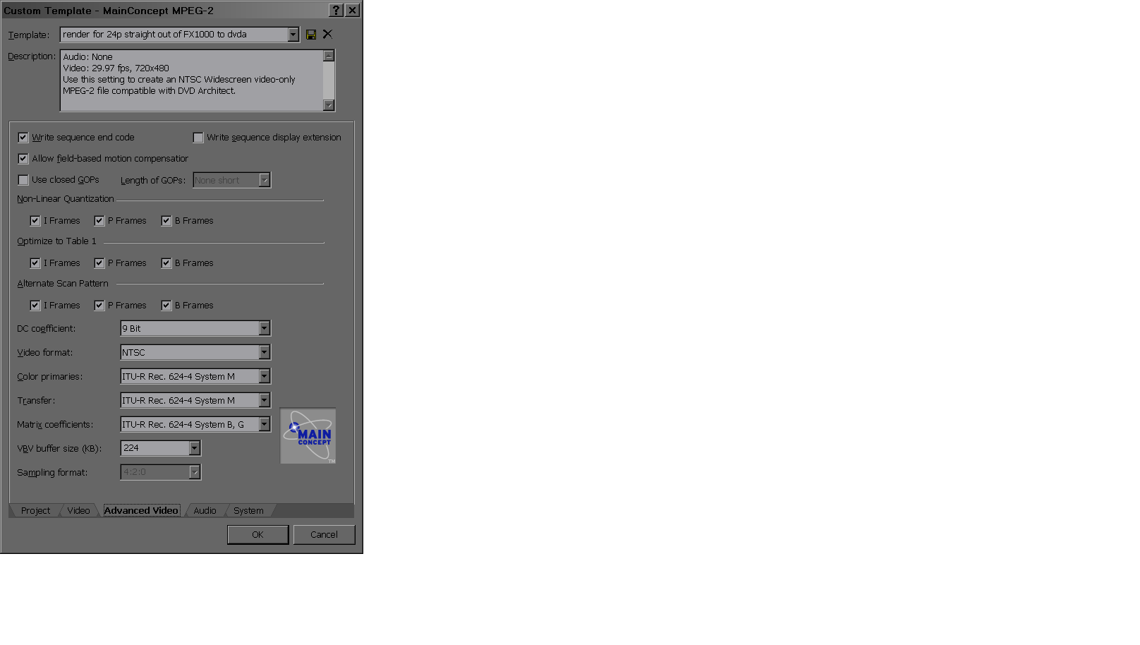

I've only rendered to dvd. Here are the Project properties and render settings to dvd.
FX1000, HDV and 24p-dvd-render.png   FX1000, HDV and 24p-dvd-render-project.png
FX1000, HDV and 24p-dvd-render-video.png   FX1000, HDV and 24p-dvd-render-advanced-video.png
