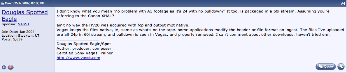

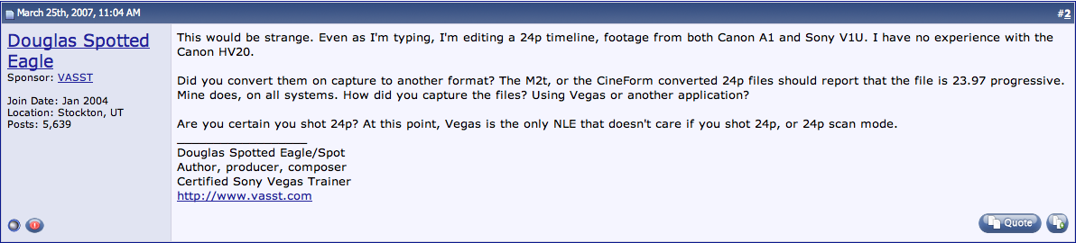

I'll look for more quotes but let's start with these from this thread,
http://www.dvinfo.net/conf/what-happ...moval-hdv.html

Well Barron, I found an article (link below) by DSE in which he says that Vegas does do pulldown removal automatically if you change the project properties to 24p.
So if DSE is correct, as he likely is, then you are correct and I was wrong.
