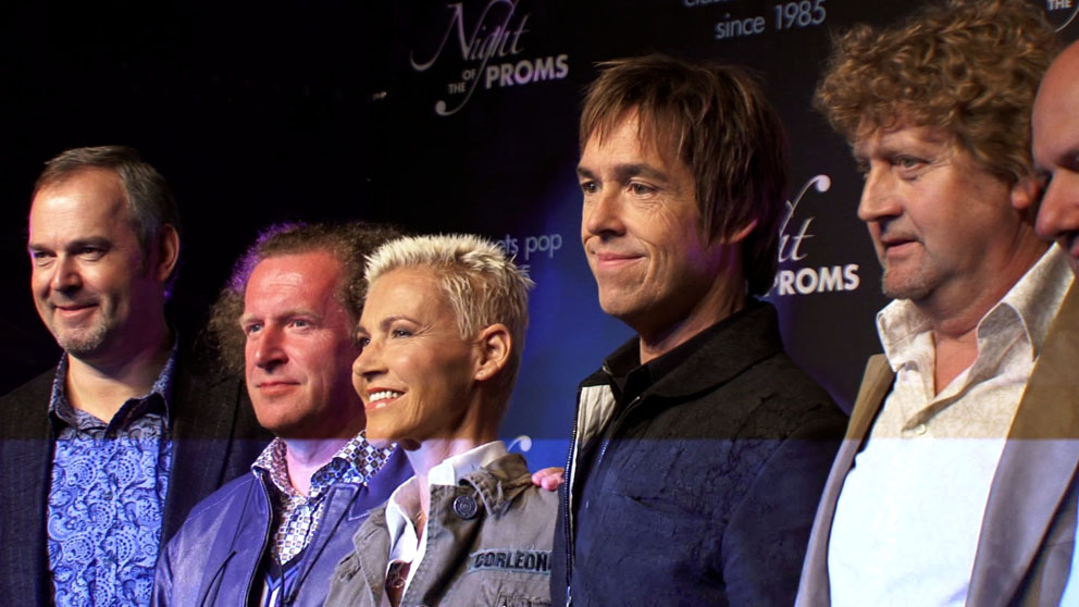

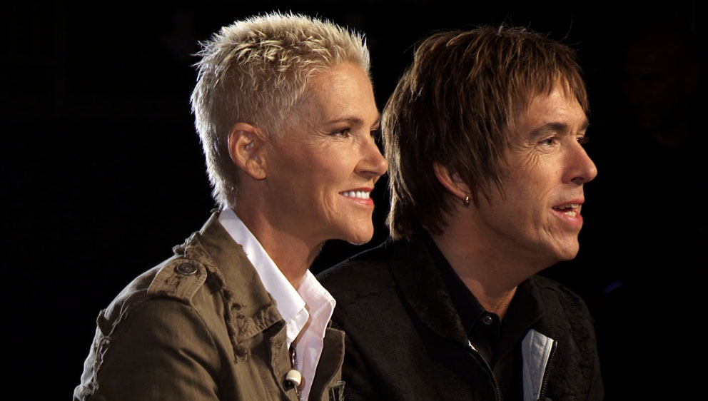

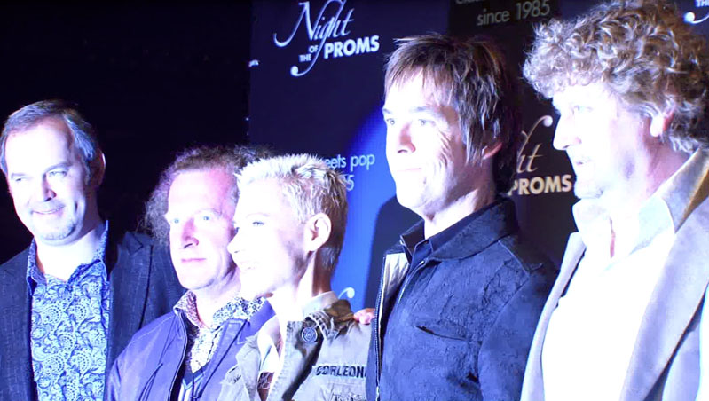

Well, everything is relative. The other day I was filming at the press conference where the come back of Swedish pop group Roxette on the Night of the Proms was announced, and there were at least 20 still photographers, with just as many flashes going off all the time. All three the screen grabs you see here are from the Z7 with its CMOS sensors.
On several occasions I have frames that are entirely overexposed because a flash went off in synchro with the rolling shutter (example 1). On some other frames you can see the typical banding caused by the flash out of synchro with the rolling shutter (example 2). Mind you: in my clip, 4 times out of ten there's a flash in synchro. Personally, I even prefer the frames where it is OUT of synchro, because the overexposure effect is much less visible.
The third example just shows the fantastic image quality of the Z7 (and Z5).
Yesterday I showed this footage to an audience of 30 experienced videographers and very few of them had noticed the rolling shutter effect before I pointed it out myself. So for me it's not a big problem, and no, I'm doing no weddings at all, but I'm very often in the presence of many many flashing colleagues.
