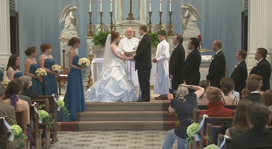

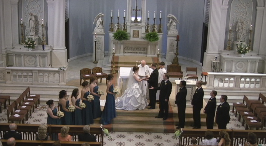

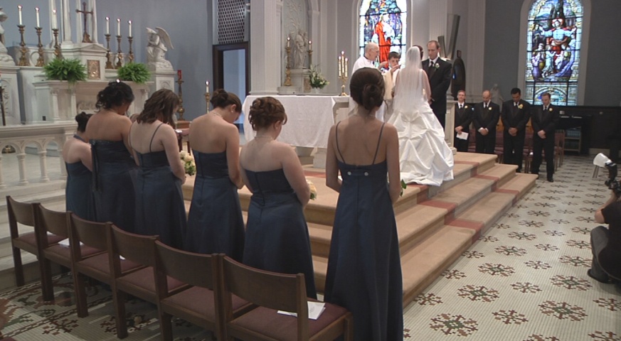

Images from FX1000/Hv30/HMC150
The following images do nothing to answer Tim's question about low light of the HMC150, but here they are anyway.
I find the HV30 to be a remarkable of performer in decent light. For a $400 (used) dollar camera is it quite good. The FX1000 looked very good of course, as this was a well lit church.
I don't have images from the HMC 150 of the reception (which would be much more useful to all of us) that are usable for comparison.
Please don't ask why the Panasonic was located where it was. I had given instructions that the Panasonic was to be in the balcony next to the HV30 but obviously the shooter had other ideas! If I were to place an unmanned camera down front off to the side the obvious place to me would be on the groom's side to catch the bride's face.

Jeff, I've got the HV20 and think it's a great camera. But you can see the '1-chip signature' in the HV30 clip when you compare it to the FX1000. There seems to be a much greater color tonality in the FX1000 as a result of the 3-chips.
That's probably the single greatest issue in trying to match the little guys with the big boys. Sharpness & detail is rarely an issue, especially since some of the little cams actually have greater resolution than some of the big guys.

You're right, of course Ken, but the similarity of the colors, etc. sure is good, especially with auto white balance. Don't get me wrong, the HV 30 is definitely off a bit and not nearly as precise, but still pretty darn good.
In a darker church a few weeks ago I ran the HV30 and it the footage is virtually unusable. In good light it's great, but as soon as the light drops it's useless without additonal lighting.
