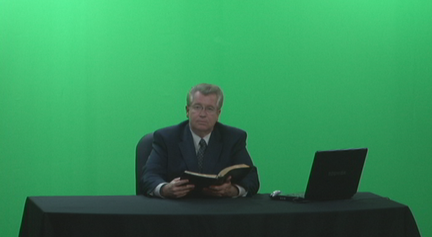

Screen Shot
Here is a png of the video.
But like I said, when capturing the video in Vegas Pro 10 the capture screen is clear and sharp, but this is what I get when I bring it into Vegas.
Jeff Kerry is offline   Reply With Quote

Re: Hvr-z5u
The first thing that jumped out at me is some flash from the green screen. In the talents hair, on the edge of the chair, the left vertical of the black tablecloth on the rear corner and the left edge of the computer.
That says to me that 1) the talent is a bit too close to the green screen and it needs to be lit a bit differently. Without seeing the exact lighting setup you used it's hard to say exactly what needs to be done with the lighting but I can say the reason it looks sharp in the capture screen is because the capture screen is generall pretty small in comparason to the preview screen also there might be something going on in the timeline. Is there any FX applied or is the opacity slider set to anything less than 100% which BTW can happen without ever realizing it.
I would check all of that first then try keying it out and see what happens to the image. At least that way you have more of a direction to go in. Otherwise, it really is a guessing game. Let us know.

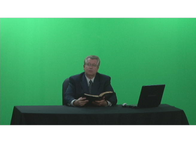

Re: Hvr-z5u
Don,
Thank you for the suggestions. But sorry I uploaded an image for what I was trying to work on correcting.
Here is a copy from the captured video off the tape. Nothing added or any FX applied. The opacity is at 100%.
Just not sure if it is the way I have the camera setup also, but itis at the church and ot with me to check the settings.
Jeff

Re: Hvr-z5u
Jeff, I still see some flash on the corner of the table, the laptop and the chair so that might cause you a problem with the key but as to why the image seems to be going soft check in the Sony NX5 forum here as IIRC theree was a thread about greenscreen work with the NX5 and what the proper cam settings should be. I think there are a few threads regarding soft image and greenscreen that might benefit you way more than I can.

Re: Hvr-z5u
well if you consider about 900 miles to be close but for an order from Cafe DuMond I might....;-)
If you're going to redo the work I would pull the minister forward about another foot or 2 if you have the room maybe frame it a bit tighter and use the least amount of lights possible. I shoot talking heads on greenscreen and use 2 600W softboxes at about 45 degrees left and right from the camera. As long as it's evenly lit with no hot spots or shadows that show I happy. It is very quick, down and dirty and worls like a charm of course I shot this stuff SD for the web for my clients intranet sites but the principles are the same.

Re: Hvr-z5u
Light the face in the foreground, independently, it seems he now gets most of the light indirectly from the green background.
Increasing the distance between green and person is always good
With faces on the Z5, always use manual focus. Actually, always use manual focus.
Those lights that light the green screen, do they shine directly into the lens? The Z5 does not like that.
Frans Meijer is offline   Reply With Quote

Re: Hvr-z5u
judging from the image you posted that has to be the worst lit chromakey i've seen in a long time ;-)
frans's post sums it up - light separately, get some space in there....
