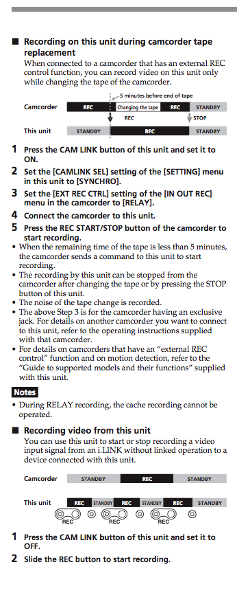

From page 12 of the Sony Manual:
Recording on this unit during camcorder tape replacement When connected to a camcorder that has an external REC control function, you can record video on this unit only while changing the tape of the camcorder.

Press the CAM LINK button of this unit and set it to ON.
Set the [CAMLINK SEL] setting of the [SETTING] menu in this unit to [SYNCHRO].
Set the [EXT REC CTRL] setting of the [IN OUT REC] menu in the camcorder to [RELAY].
Connect the camcorder to this unit.
Press the REC START/STOP button of the camcorder to
start recording.
• When the remaining time of the tape is less than 5 minutes, the camcorder sends a command to this unit to start recording.
• The recording by this unit can be stopped from the camcorder after changing the tape or by pressing the STOP button of this unit.
• The noise of the tape change is recorded. • The above Step 3 is for the camcorder having an exclusive
jack. For details on another camcorder you want to connect to this unit, refer to the operating instructions supplied with that camcorder.
• For details on camcorders that have an “external REC control” function and on motion detection, refer to the “Guide to supported models and their functions” supplied with this unit.
Notes
• During RELAY recording, the cache recording cannot be operated.

Here's a screen shot of the manual
